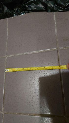

Complication arise when retiling bathroom partially
Hi everyone
When we removed the bath from the bathroom, we didnt realize its actually difficult to find new floor tiles of same style with the existing one.
Existing tiles are all 20 x 20cm.
Now our plan is to find the same size ones but in different colors.
And after tiling the bath area, we can paint both new and existing tiles with same color.
One major concern is, the bathroom still has a shower. But we hv seen some people painting on the shower floor without any issues.
Is this a good plan ? To paint both different tiles with same color - the existing purple tiles look horrible anyway lol.

Hello @ivanptr
If you are after a quick fix, it is possible to paint your current floor tiles and the new tiles that you'll be installing. However, I suggest seriously thinking about the possibility of re-tiling your bathroom floor. It will be hard work but the repairs you'll be doing will be for long term use.
If you are considering painting the tiles, I suggest having a look at the Dulux Renovation Range. It is water based and easy to apply.

@EricL , @Thanks for the alert ! then we will attack the whole bathroom floor
How is it feasible / common to tile over existing bathroom floor tile ?
Our old tiles are 20 x 20 cm, with no visual damage. Compared to retiling, Is it equally easy for the tiler to install 45cm x 45 cm over old tiles while maintaining proper fall at our shower recess area?
Our plan is get a waterproofer to waterproof the old tiles before we get tilers to put new tiles on them.
Hope it can save project cost (without removal)
Re: Complication arise when retiling bathroom partially
Hi @ivanptr
I suggest speaking to your tiler regarding tiling over existing tiles. It is possible to do it, but your tiler will probably need to assess the area before they say yes or no. Waterproofing is one of them main issues of tiling over tiles and the change of the floor height. The bathroom door will also need to be modified to take into account the change in floor height.
The fall in the shower will translate into the new tiles, however, the shower waste will need to be modified to take into account the new height. I recommend speaking to your tiler first regards to what will pass council rules and regulations.
