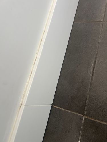

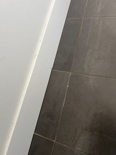

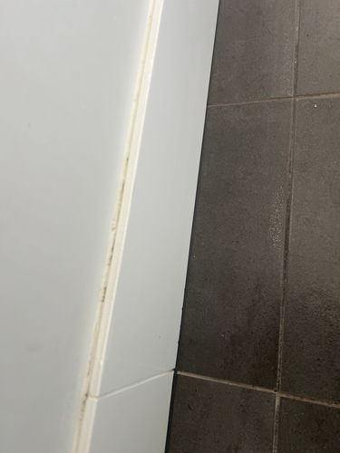

 Hi. The photo show the area between the tile and the wall after cleaning it. what is best to use to seal it or paint it and make it all nice and white again? Many thanks  

You could go a couple of ways with this — you could either apply grout into that gap to match the tiled surface, or you could use a white silicone sealant instead. Silicone would be a good option because it would fill the gap and also seal the porosity of the exposed tile adhesive, helping to prevent any moisture getting in.
Here's a helpful guide: How to apply silicone sealant.
