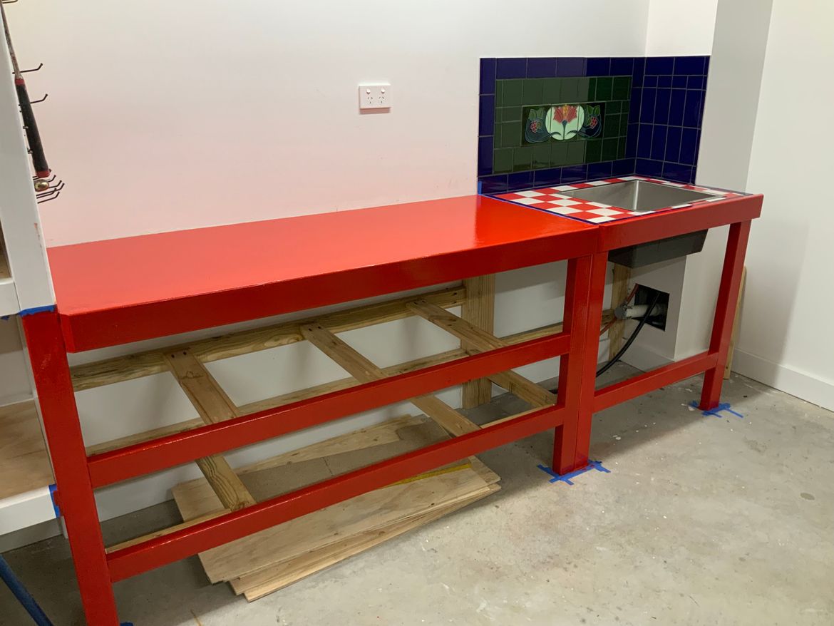

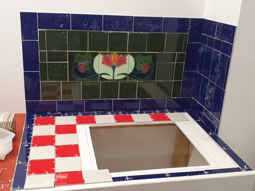

We needed a sink downstairs in our garage. A friend built us a fabulous storage area with a workbench and sink stand. We have just about finished painting and tiling the bench and sink.
We already had the feature and blue and green tiles. We bought the Johnson bros red and cream tiles and the dulux gloss red to finish the project at our local Bunnings. The range of Johnson bros tile colours available has decreased, which is why we went with the red and cream as they were the only ones compatible with our feature tiles.
We just need to get the plumber back to install the sink
Materials
Tile cement, spacers, tiles, grout
All easily found at Bunnings
Tools
Tile cutter, tile nipper, squares and levels, lots of patience
Steps
Step 1

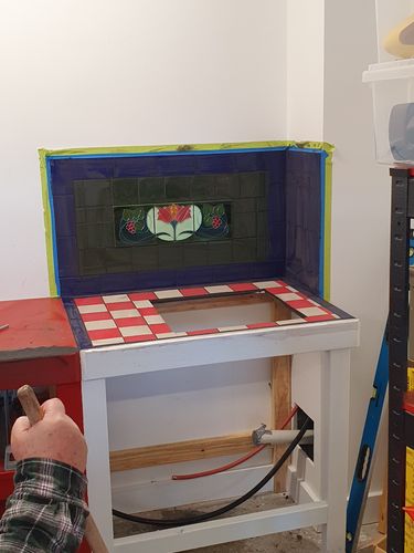

Sealed the wall and sink surround
Step 2
planned the tile pattern
Step 3

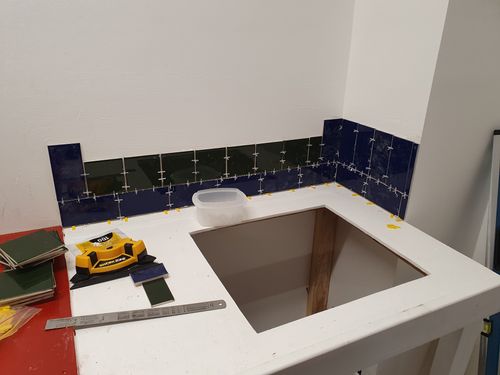

Measured carefully around the sink so all the lines would be square to the sink and marked grid lines.
Step 4

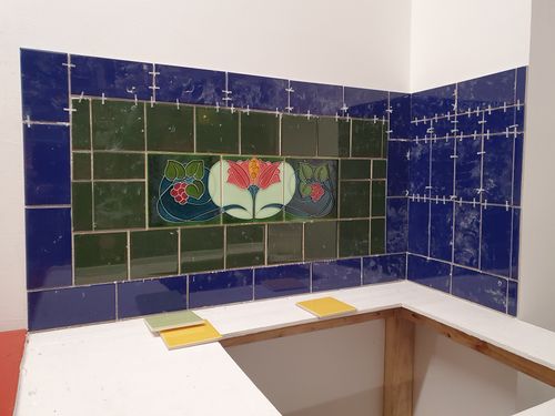

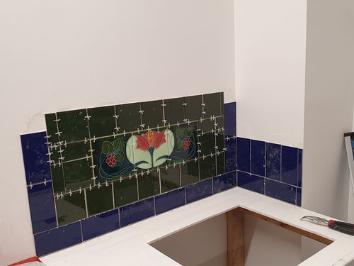

tiled the easy bits, the whole tiles first on the walls
Step 5
cut the tiles as needed to finish the wall
Step 6

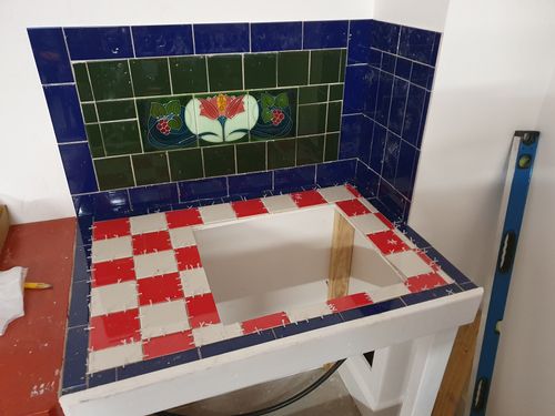

cut the blue edge for the sink surround for colour continuity
Step 7
tiled all the whole tiles first, then cut the missing pieces
Step 8
did a little angle grinding to ensure the sink fitted
Step 9
grouted it all and then admired our work while waiting for the plumber
