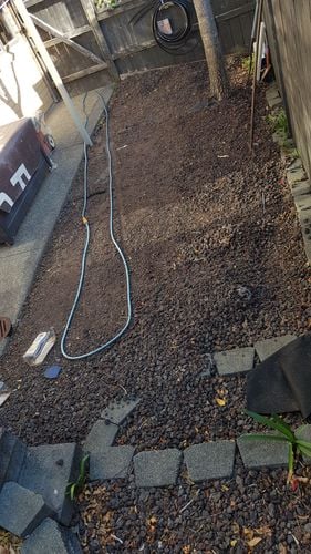

I moved to a house with no garden shed and planned to instal a base for a kitset wooden garden shed to sit on, on this landscaped slightly slopping uneven leve west side area. I have time to DIY (retired) after concrete base option removed. Started to cut the serpent tree. After stump is removed, is it ok to use timber pegs drive into soil as posts and start from there.

Hi Jason, concreting is a heavy workload to me.

Hello @yusop
My apologies for the late reply. Depending on the size of the base you are after, it is possible to build the base in sections. In this manner you will not be overwhelmed with the effort of building a base. I suggest having a look at this discussion - How to pour a concrete slab by @tom_builds.
In the discussion you'll see how a small slab is created and the possibility of building another one beside it.
