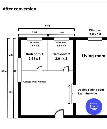

Our living area is very small so we are now planning to convert our garage into the 2nd living room. Now the door between garage and the current living room is a single pocket door.
But after the conversion, it seems to be better to use a wider door to open up space when there are two living areas.
But we are a bit confused on which type of double doors we should use -
- Double sliding pocket doors ?
- Double barn doors ?
- Or any other type of door would suit better?
Its our first time doing this kind of project.
Any any advice would be much appreciated🫂

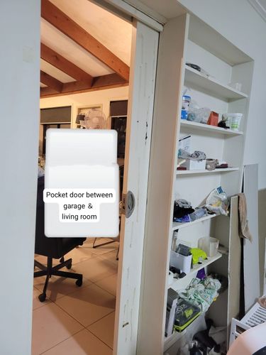

Can we DIY and widen the doorway only with tools from Bunnings?
Hi Brain Trust,
This might be complicated but we wonder if we do this slowly and step by step, is it possible to widen the doorway by ourselves simply using tools and equipment from Bunnings?

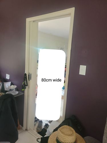

This is our current sliding door (80cm wide) :
And we want to widen doorway to 110cm to install a barn door on the living room side:
This requires work to
1) remove the recessed wall shelves.
2) remove the pocket door
3) widen the doorway
Thanks in advance for any advice🙏😊

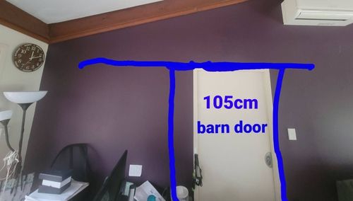

Thanks Eric for all the advice! we have decided to use a single barn door due to the benefits you mentioned.
Now we are proceeding to the installation planning️ , would love to hear your thought
Re: Can we DIY and widen the doorway only with tools from Bunnings?
Hi @ivanptr,
That's certainly possible and not overly complicated as long as you take it one step at a time.  A question, though, why do you want to widen the doorway? Is it just for the looks? You could simply install a 105cm barndoor over the current opening. Due to barn doors being on the surface of the wall, they are always larger than the opening. In your case, the barn door would be 25cm wider than the opening, which is not unusual. In the closed position, the door must extend past the opening while covering the other side. So, in the closed position, there will be 12.5cm of overhang on either side.
If you were to widen the opening to 110cm, you'd need a barn door of at least 120cm to cover the gap.
If you are opening the doorway for looks, then I can certainly see the benefit of going to that amount of work.

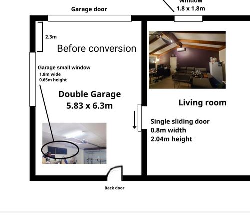

Because we want to have a widen doorway to open space up after the garage is converted to a 2nd living room with 2 extra bedrooms:
We reckon it might feel more spacious when the doorway between 2 living area is wider.
And then we think it might be nice to have a barn door as it can provide a medium amount of audio privacy for the people resting in the new bedrooms at night.
Not sure if this makes sense🤔
That makes perfect sense, @ivanptr. Always nice to have an open transition between two living areas.
The initial steps will involve demolition @ivanptr. It would be worth having the wall assessed by a builder or structural engineer to determine if it is load-bearing. Given a portion of the wall appears to be a recessed bookshelf, that seems unlikely. Once you've checked, you can begin by removing the bookshelf. Start with the end panel, which the shelves connect to. You might have to cut it out, or a few swift whacks with a hammer might do it. You can then remove the shelves and start cutting the "wall" away. I'd suggest you must demolish the bookshelves, remove the cavity slider, and then re-build the wall from where the end of the bookshelf was to the edge of the new opening. Here are a couple of helpful step-by-step guides: How to remove a stud wall and How to build a stud wall.
Due to the custom nature of your recessed bookshelf/wall, I'm unable to give you an exact method of how to deconstruct the wall, but I'd suggest removing the bookshelf pieces will begin the process. That will give you access to the rear of the cavity slider and allow you to start cutting it out. A reciprocating saw with an extension demolition blade will come in handy.
Once you start taking the wall apart, you can provide further update images, and we can suggest the next steps. Please let me know if you have any questions.
