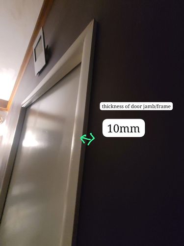

1) Is it also better to remove the original door casing / trim for our plan to widen the doorway?
Cos when the opening got widen, we will need longer trim to cover the whole doorway. (But I dont have any spare part of the original trim. Its installed by last owner)
2) For a barn door , the current trim seems be quite thick with 10mm thickness?
Better to use thinner trim / casing to bring the barn door closer to the wall?
Thanks for any advice.
Re: Can we DIY and widen the doorway only with tools from Bunnings?
Hi @ivanptr,
I would have thought that if you're widening the doorway, the trim will need to be removed. Once complete, you'll likely need to replace the whole trim with a new one.
You can use a thinner trim if you'd like. Or you don't have to use a trim at all and can plaster the edges, which would be a more appealing look.

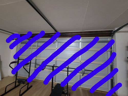

We have decided to retain the garage door, but add a stud wall behind the garage door to convert the garage into another living area. (And in future if we want to turn this room back into garage, we don't need to reinstall the garage door.)

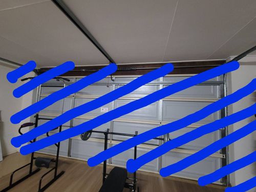

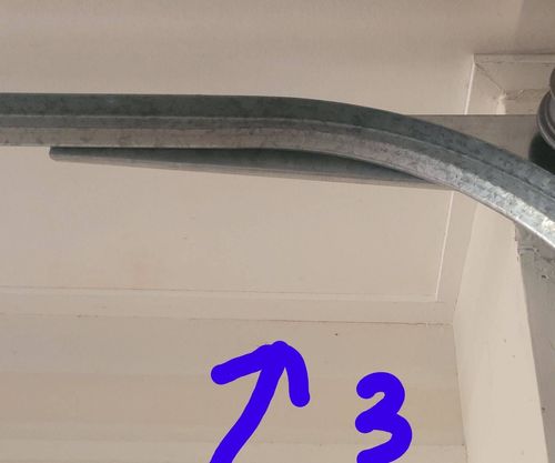

We noticed there are 4 areas that we dont know how to deal with :

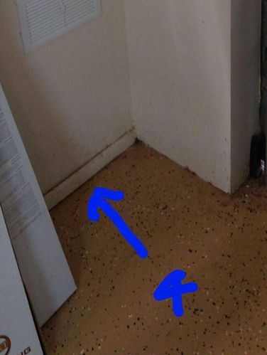

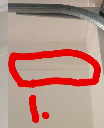

1. A trim on wall?
2)  Some kind of ceiling cover?
3) Cornice
4) Skirting board
Could you tell us which one we need to remove ? And what tools should we use and how?
Thank you for any advice in advance🙏
___________________
(Curent goal - to build a stud wall behind the garage door)
Hello @ivanptr
Picture number one, three and four are just timber trims, they can be removed using a Craftright 380mm Wrecking Bar. But if you only need to remove a little and trim the end to allow your wall frame to fit in, I suggest using a Multi Tool with a Kango 3 - Piece Titanium Toughened Plunge Cut Multi-Tool Blade Set KOATV-3. This will allow you to cut the timber trim without having to disassemble the entire trim.
In regards to picture number two, it is called a James Hardie 2400 x 4.5mm PVC Straight Jointer. They are used to join large ceiling sheets together. Again, you can trim off the small piece that you don't need using the Multi Tool.
Before you begin, I suggest taking many measurements of the area where you are planning to build the wall. I then recommend drawing it on paper or computer, this will help you visualize what you need to do and the steps you need to take when you begin your assembly.
Please remember to wear personal protection such as gloves, goggles and a mask when while working on your project.
If you have any other questions we can help with, please let me know.

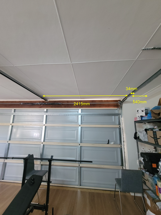

Hi @EricL

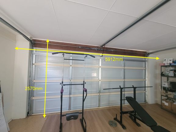

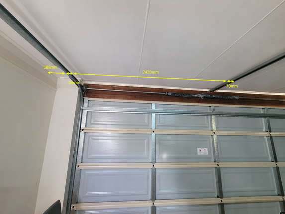

We've taken the measurements , from left to right:
Aggregate:
Now we have taken the measurement and will then use software to visualize them

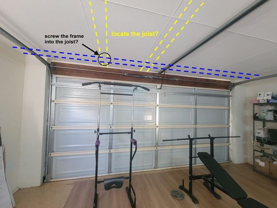

1)
For the ceiling, we need to use stud finder to locate the ceiling joist ?
Can we directly drill the screw the frame into the joist through the ceiling sheet? or we need to remove the ceiling sheet first?
2)
For both sides, is it necessary to locate the stud behind the drywall first? or can we just screw the frame to drywall?
3) Which structural pine wood should we buy?
https://www.bunnings.com.au/products/building-hardware/timber/framing-timber/structural-pine
Wholehearted thanks for your help.🙌
Regards,
Ivan
Hi @ivanptr,
1) You can directly drill and screw the frame into the joist through the ceiling sheet—no need to remove it.
2) It would be best if you could find a stud on the wall to attach your frame directly to. If the frame is secured solidly to the roof joists and into the floor, you could potentially connect it to the drywall on the sides.
3) You'll be using H2 Pine to construct the frame; the minimum calibre would be 70 x 35mm.
