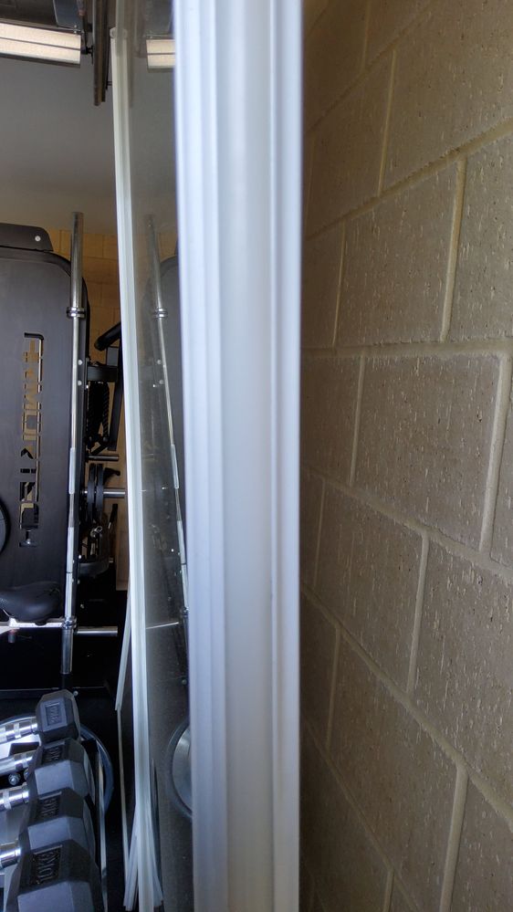

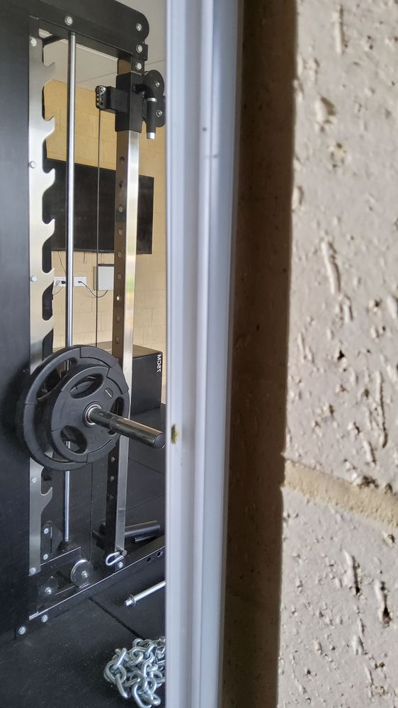

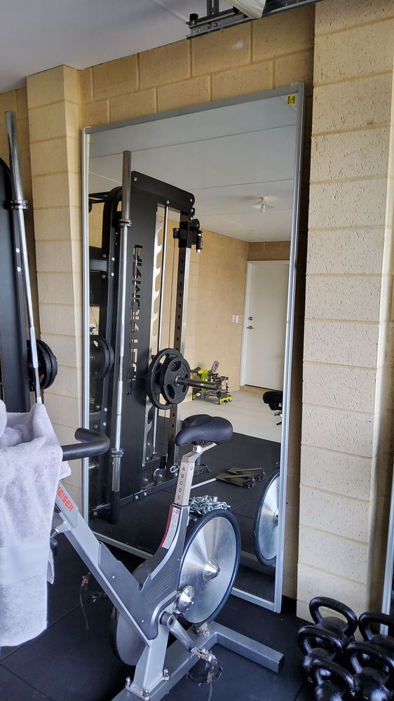

Wanting some advice on fixing large mirrors to brick
Picked up these sliding wardrobe mirrors doors for a steal and going to use them as gym mirrors
Ideally I'd like to remove the frame but I think there's too much risk in the mirror breaking because it's quite thin.
I'd say they would weigh at least 30kg each

Many thanks for your comprehensive response, I'm definitely going to have the mirrors off the floor. I've used dynabolts before with varying success, sometimes they don't grab due to the hollow spaces in the brick. Maybe I'll consider longer bolts to increase the chance of them grabbing.

Those angle brackets look great but do they come in U shape rather than just an L shape?. It would give me a bit more piece of mind and would prevent the bottom potentially slipping off the brackets
