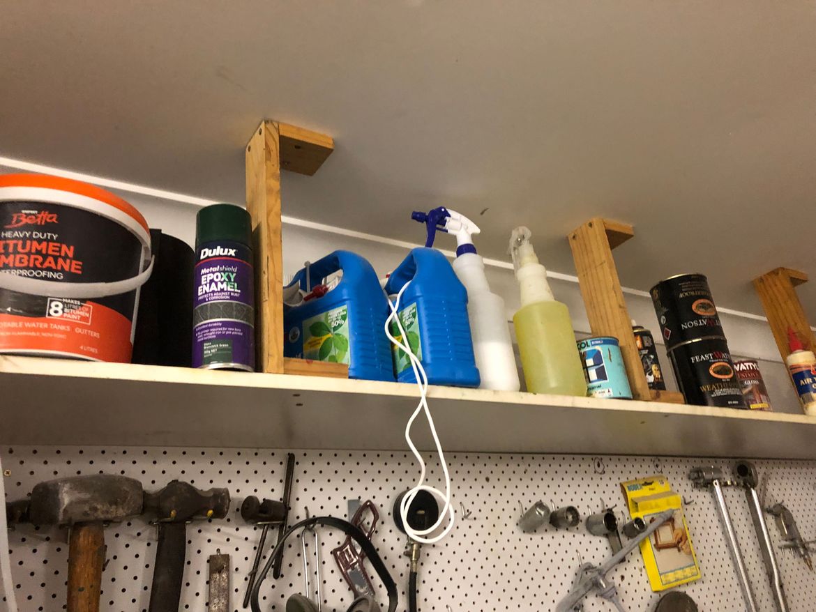

I have similar garage shelf like yours and I attached timber to the roof to ensure no sagging brackets. see pic Instead of using brackets I bolted a timber rail across wall and sat the shelf on top of it. I then added tool peg board to the timber underneath as a bonus. Thats held for 22 years todate. But I have the roof supports in the way so thats a design glitch if i had to put some thing long up there. But it sounds like you potentially want to really pile some weight on your shelvesTimber rail under peg board

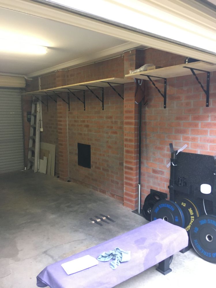

Very happy with 9.6m of extra storage space now (shelves are 520mm deep).
Our small little single garage will offer so much more now!
Many thanks for your input, it's greatly appreciated.
Pic attached here of finished job.

Nice pics of your project @gmw72
I here you about 1 silly small thing going wrong or some time more things dont go as planned thats why its good to use simple fixes along the way as they are an onsite life saver.
If you strive for maximum strength get the next size up anka and screw it in but you might need to drill bracket hole larger too.
You really increased your storage space for any sized object with 520mm wide space those larger boxes for exampe.
