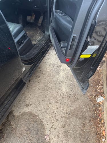

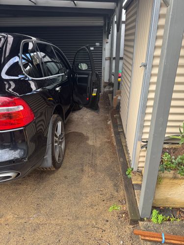

Looking for suggestions for economical and easy ways to improve our 4m x 6m carport in Richmond. As you can see from the pics it’s a combination of sound and dirt and it ends up coming inside the house. In an ideal world we could repave, but I’m wondering if there are hacks such as matting that we can lay over the top,
and any tips for installation?
update: it’s on a slope - roughly 50 cm down into the lane over the 6m. And based on Bunnings visit today and now thinking that I would do an Astroturf for the whole area and then two tire tracks with extra strong matting. Something like the attached pic
