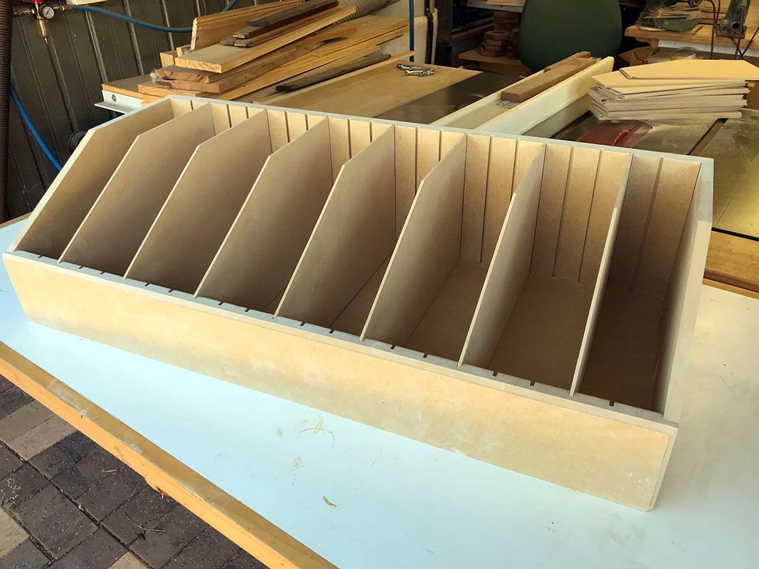

I saw a need at work to display/store Drum Sander sandpaper rolls in a better manner, they are an awkward thing to display in a tidy fashion with so many varying lengths and grits.
So here is what I cam up with...
I made 4 of them which are approx 800mmW x 350mmD x 200mmH and will siit side by side being a total width of around 3200mm.

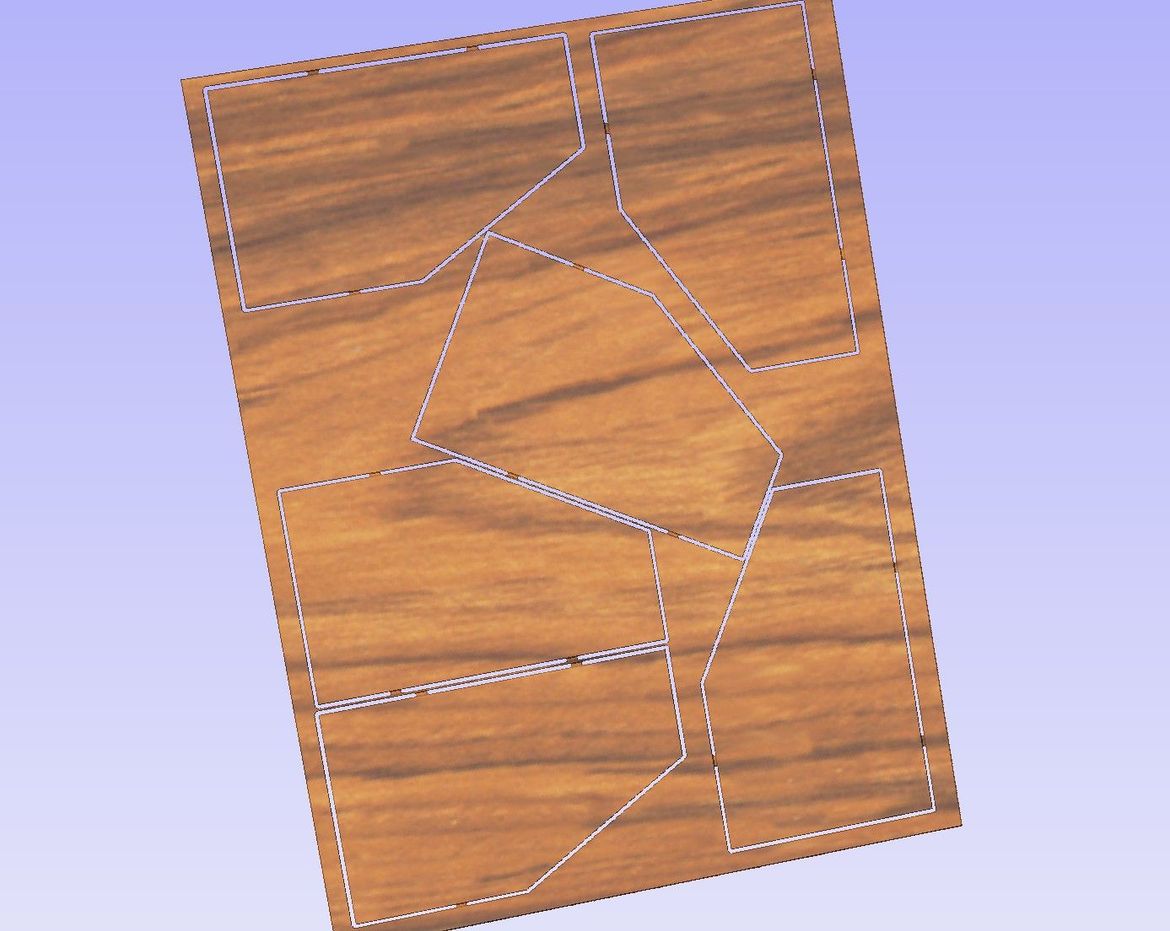

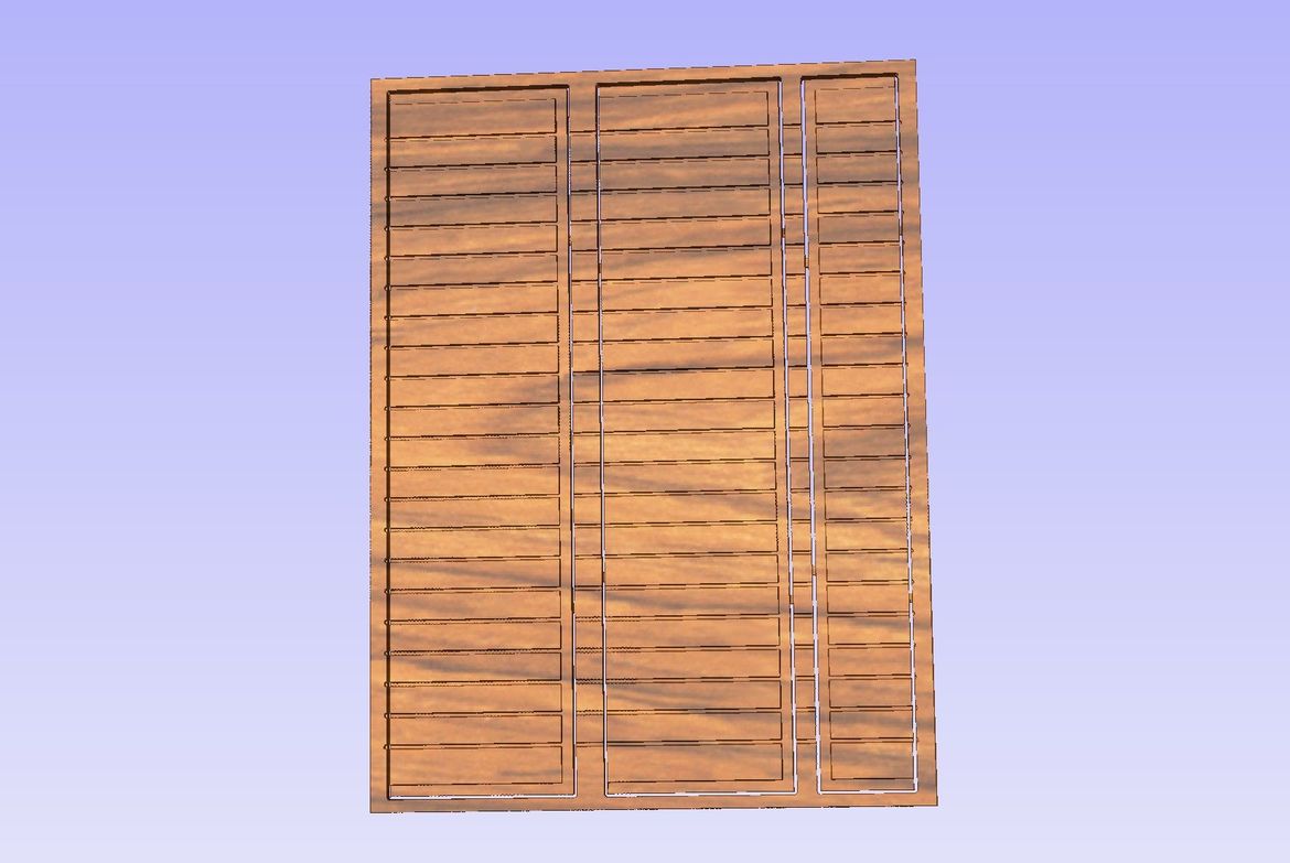

I designed and cut all the relevant pieces using my CNC machine, 4 Fronts, 4 Backs, 8 Sides and 36 Dividers using MDF in 18mm, 12mm and 3mm then cut the Base panels in 12mm MDF on my table saw.
