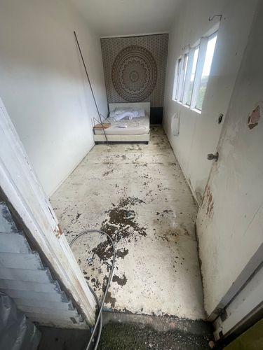

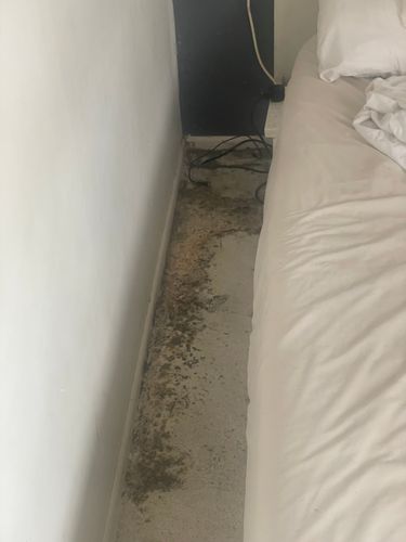

We have a room attached to the garage and the flooring is concrete which currently has parts of mould, what can I do to get rid of it and help prevent it? We’re also wanting to put some kind on flooring foam mats or something so what is the best way to go about doing all of this
we have brought a quick patch to cover and chipping or holes
thanks in advance for the advice

I suggest doing a bit of an investigation as to why mould grew in that spot of the floor. Mould growing on any surface is often an indication that water has settled in that spot allowing mould spores to grow unchecked. If there is a leak in that spot that must be addressed first and sorted out before you move forward with your renovation plans. The actual removal of the mould is straight forward, use an Oates Long Handle Deck Scrub Brush along with water and detergent.
Once you've determined that there are no more water leaks, I suggest looking at Hybrid /flooring. It is 100 percent waterproof and is relatively easy to install.
Here is a handy step-by-step guide: How To Lay Laminate Flooring
