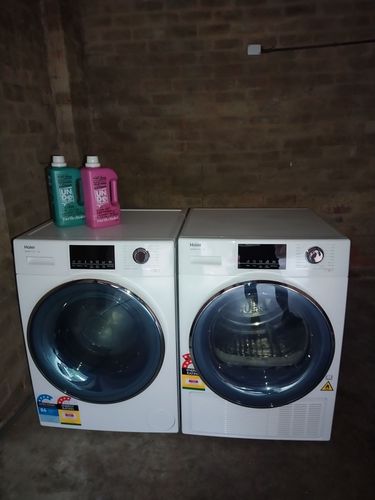

Okay I did it! And I have done a load of washing/drying and it turned out okay, but I had to make some changes today.

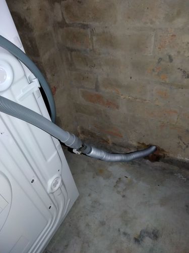

Initially I had the appliances too far away from the hole in the wall for the drain hose. It seemed to struggle a bit, and then the hole was too small for the drain hose so when I pulled it through it got damaged and was a bit leaky, it was also too flimsy to hold itself over the drain properly when it drained. But those were yesterdays problems.
This arvo, I moved them right next to the drain hole, but I have no drill, and lockdown means no Bunnings for me,
so I just spent around 4 hours making the hole bigger, this involved wetting the bricks a lot, and then using a flathead screwdriver and a mallet thing to smash into it, it was very slow going but I got there in the end and managed to squeeze the hose through with no damage, so it shouldn't leak anymore. I got that white cover thing to hold it in place over the drain so hopefully all the water goes in there now, I will cable tie them together once I get some ties.

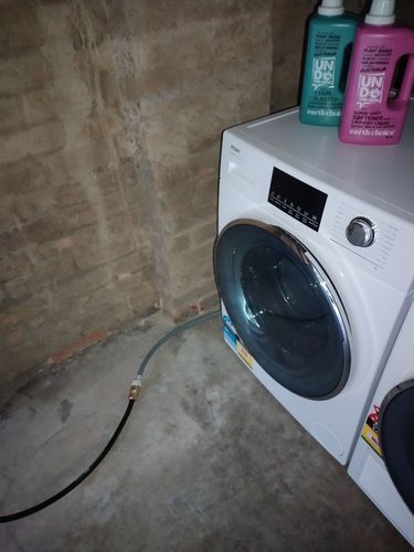

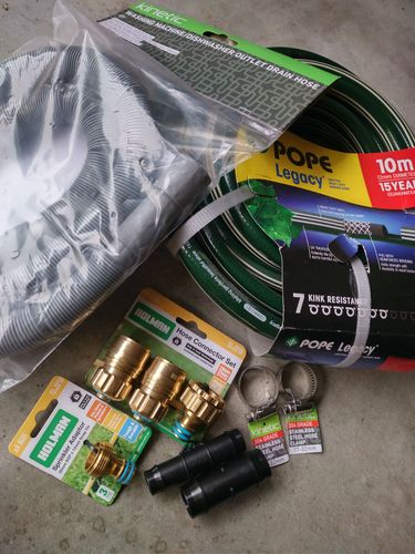

The tap, hose fittings and sprinkler adapter all worked as you suggested and that was no trouble to connect to the machine, as you can see, I have the hose just poking out of the wall so I can pull it up and connect it when needed, easy.
And in other news, the landlord was here yesterday to deal with some faulty electricity stuff and I asked if it would be okay for me to do this and he okay'd it as long as all the water goes down the drain, so I wont even get in trouble, yay.
I'm happy to not have to go to the laundromat ever again, and I would like to say thankyou to everyone who gave me advice, particularly @redracer01
