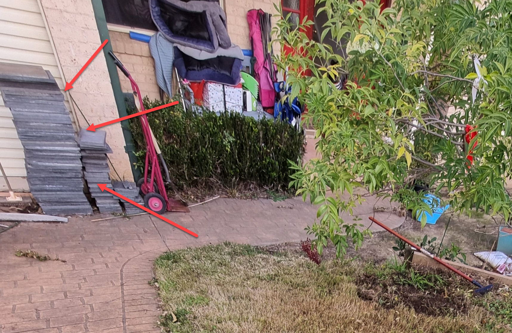

Are these the pavers you are planning to use here?
How thick are they? They look like they are about 20mm thick at the most.
Unfortunately, if these are the pavers you are using and they are as thin as I am estimating, there is no way they would be strong enough to retain soil long term. Keep in mind that they need to retain the weight of the soil plus any groundwater that sits in that soil. Even though the rises are only 120mm, I couldn't say with any confidence that they would be able to resist the force of the soil pushing on them long term.
You could still use them for the landings and to clad the risers, but they would need to be supported by something with the strength to retain soil.
@AlanM52's solution of installing timber sleepers with stakes would considerably reduce the price and is a tried-and-true method you could be confident would work.

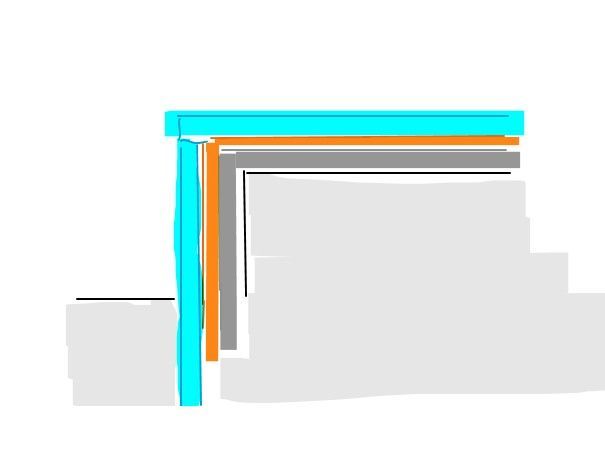

Thanks Jacob, yes the pavers are 20mm. I may be out of my depth here, I got very confused by tent pegs, cement sheets, digging back and where to put retaining wall blocks. I'm not going to use crushed gravel as underbed, as then I'd have to retain it at the sides, making it a more complex job. My plan is to dig each step (the ground is mostly compressed clay). Then I've bought quick-set concrete to use as a bed for the tread and riser for strengthside view step; I'll use a thicker amount for riser. I'll allow that to set for a couple of hours (if not more) then will add a layer of mortar, dig the paver for riser into ground (it'll will be going in half it's height). Then add mortar to tread, top with pavers, then use mortar to sides to prevent soil washout. I'm planning that steps will sit below the ground level, not above. See diagram for layers of concrete, mortar, paver. If it fails, I'll use the leftover mortar to make a slide down the slope and use a rope to get up again!

The problem with using clay as a base for any kind of hardscaping is that it is prone to moisture retention and expansion. If the clay becomes waterlogged, it can expand, shifting everything that sits on it.
Without a proper base and soil retention structures, there's a high likelihood that your stairs will not last the test of time. This is not to say they won't work for some time, but over the course of many rainy days, there will likely be movement.
I don't want to completely deter you, but I want to give you the facts so you can make informed decisions.
You seem fairly happy to give it a crack and see how it goes, which is great. I just want you to know the possibilities. Ultimately, the pavers will not be damaged, and mortar and concrete can be removed, so you can always try again if something goes wrong.

Good advice. Im hoping that 30 years of having a lawn on it, and not digging too deep will mean there's a mix of clay and soil. Also being on a steep slope should help with drainage. You'll be impressed, I dropped in on Bunnings last night on my way to dinner and picked up 45 Brighton masonry bricks!
