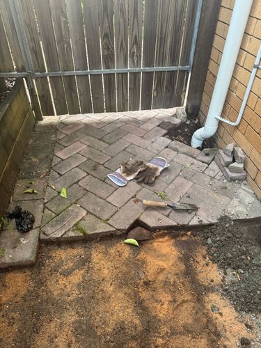

  • Previous owners laid pavers and stormwater drainage pipes too high beside my house, plugged up the weepholes in bricks for years and caused rising damp inside lower level (just fixed professionally and quite spendy).
  • Problem exacerbated by use of an ag pipe (also previous owners) for part of the stormwater beside the house instead of a PVC pipe, connected into downpipes.

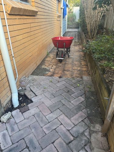

  • The side of the house is 11m long and 1.45m wide so not a lot of area to play with.
  • Clay type of dirt, high water table after years of rain.

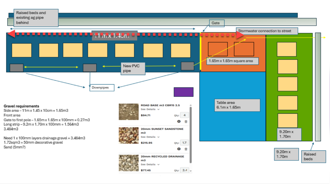

The project (see drawing)
  1. Removal of pavers (partially done)
  2. Dig down to bring ground level lower than bricks (currently at least 15cm above the bricks, we're hiring a kanga)
  3. Slope the ground away from the house and create fall down to where pipe will join stormwater (there is a nice existing fall once you get past the side of the house towards the front)
  4. Trench and installation of PVC stormwater pipe at correct level (will get plumber for connections) - will use 20mm drainage gravel all around pipe and wrap in geofab
  5. Create a gravel path with 600mm x 600mm paver steps
  6. Plan is weed mat + pins, roadbase or 20mm gravel (100mm deep), compact, sand (50mm? deep), compact, install pavers, decorative gravel (50mm deep).
  7. Lift old pavers out front of the house and reuse side pavers, as well as another gravel path.

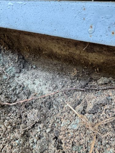

As pictured, I think what is there now is sand and roadbase (see pictured). We are going to have to dig out so much to dump in a skip, and planned to buy new stuff, but is there a way to reuse?
The problem is it'll be all mixed up and the material will have grass/weed seeds all through, weeds have been a real problem and want to resolve that as well. Could we maybe do the first 50mm layer old dirt and compact, then weedmat, then 50mm fresh roadbase or gravel? Gravel appeals more for drainage benefits. Then 50mm sand, then 50mm decorative gravel.

Yes, you can absolutely reuse materials; they are exactly the same as what you would purchase, they are just all mixed together. If you are using a kanga, you should be able to scrape away in layers to keep distinct materials relatively separate.
It does look like there is sand over the top of gravel or road base, so if you can do a first cut to take away the sand on its own as best you can, then run it through a sieve or wire mesh panel to remove any stones, you can then reuse it.
You could then do much the same thing with the next layer of gravel/road base, but the idea is more to remove the roots and weeds than to isolate stones from soil, as they will be mixed in together anyway. If you are concerned about seeds in the soil, it might be best to get rid of it and buy fresh material, but there is still some risk of seeds being in fresh materials anyway.

I believe you are getting your 50mm over 1m figure from the National Construction Code Part 3.1.3 Drainage.
As long as the slope follows a consistent plane without any change in gradient, you won't have any issues laying your pavers. It's when you change the slope, you can run into issues. If you keep the slope consistent, you will have a slope of roughly 75mm over the 1.45m, which isn't huge. You want it to be reasonably level along the 11m plane, but the slope along the 1.45m side won't be too noticeable.
I would consider adding a channel drain against the garden beds rather than an agi pipe, as the slope will be directing your surface water towards that spot. You could then have a plumber connect that channel drain to the stormwater connection.

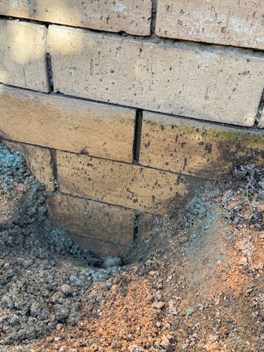

Hi again JacobZ … just one more Q on this (promise)! Our plumber will work out the drainage connections but in terms of the gravel, I dug down through sand and roadbase to clay, and that’s the original I assume. BUT, the clay-like dirt is still next to bricks. I don’t know how to tell where the damp proof course is in order to go 150mm beneath it! Should we just go 150mm beneath the last brick - so next to the footing but making sure the footing remains covered? I read that for my 1975 house the DPC may be PVC or tin. Not seen it yet. The inside has 16 bricks to window and I’m down to brick 19 on the outside. I need to keep digging but waiting to get the machine to do it.i cleaned up the bricks a bit to see. I think I can see what looks like weep holes so 150mm down from bottom weephole brick? Or will the DPC be under the weep holes?
Any advice on the DPC or should I ignore that and just go bottom brick? Thank you 🙏

Generally speaking, the DPC sits under the weephole and if you see the weephole the DPC should be visible as well. So technically the top of the gravel walkway should be at least 150 mm below the weep holes, according to Australian building regulations. This clearance is crucial for proper drainage and ventilation, preventing moisture-related issues.

I also agree with @EricL comments regarding the weep hole clearances. These are very important for in-house air flow prevent possibly mould growth and rising damp.
