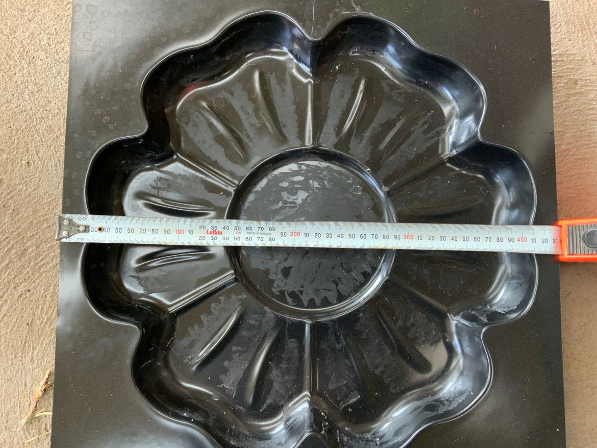

I got my moulds from Temu. I got 4 for just under $100. There are some the same or similar on Amazon or eBay au, but the price goes up to about $50 per mould. Temu were very good and even though they came from overseas I received them within a week.
I used Bastion concrete (in the green bag), unfortunately the one recommended to me in my original enquiry is no longer available. Then I used Dulux Avista Color oxide to colour the concrete. I only used half the recommended amount, approx 2 cups of avista to a 20kg bag of concrete. A 20kg bag makes 3 of the pavers. I’ve included a photo to give you an idea of the actual size. Also it says online to use a releasing agent to get the pavers out of the mould. I just used a thin spray of cooking oil, which seemed to work really well. Good luck with your project.
