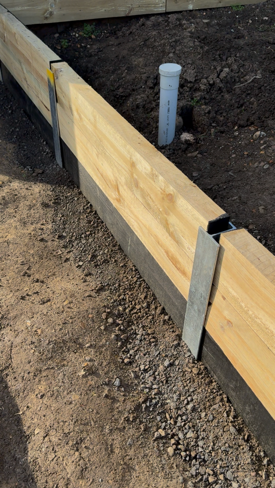

If you're concerned about durability - we have an older ~11 years old retaining wall made of timber sleepers which has some rot. I read that it is beneficial to coat the timber sleepers with Bitumen like paint (I got Bondall Timber Protector permanent waterproofing paint from Bunnings). I painted this on the bottom of the bottom sleeper, and on the ends and back of all of the sleepers. For the top sleeper I painted it only half way up the back as I'm not sure I want to see it, but you're supposed to paint it up to 10cm above the soil line. Actually after I painted them I quite like the deep black colour that it made them! I've included a picture of where I'm up to (it's not finished yet) showing the timber sleepers with the galvanised posts, and the colour of the bottom sleeper. Actually I painted the front of the bottom sleeper too as the soil will be up against much of that.
Lastly I used 200mm x 75mm sleepers that I cut 1.5m in length (from 3m lengths). That was heavy enough but I could lift and position it myself. Concrete sleepers I can only imagine will be very heavy and there's quite a bit of trial and error positioning the first one to get it level and the correct height. I could do that myself with the timber, but I reckon you'll need some strong hands with the concrete.
