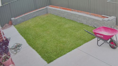

Hi guys, i have a question regarding my backyard. I am doing a DIY landscaping of my backyard, I want to put a garden bed made of adbri masonry blocks 800mm wide and 600mm high. My question is, can I use my old bricks to cover the timber sleepers under the existing fence? Then a timber retaining wall painted with bitumen in front of it before i put the blocks to comblete the garden bed of course after creating a footing. Also, do i need to put a drain? The garden bed will be along the fence. Thanks for your advice.

Thanks Jacob! What height should the garden bed be so that I don't have to put a drain? Thanks. The stormwater drain is quite far from this area.
There's no specific height @jehpets. Any garden bed needs some drainage. How are you going to be bedding the blockwork with the footing? If the bottom of the garden bed is open and on the soil, then you don't necessarily need drainage, as water will flow through it and seep into the soil below. However, during torrential downpours, it can fill with water, which is why a drain is recommended.
If the stormwater outlet is too far away, you can add some ports or drainage holes around the bottom course of blocks to let the water escape into the area surrounding the bed.

Thanks for your response. The bottom is soil and I will just put trench and concrete under the blocks (is this correct?)
almost done! Slowly but surely
