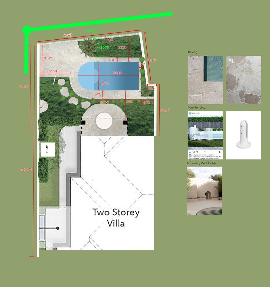

If helpful for anyone else, below are drawings for the backyard renevation:
