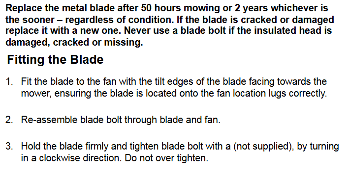

The first thing to do would be unplug the mower and turn it on it's side. Check that the blade is firmly attached. If it is loose, then that could be the reason why the motor and drive shaft are not connecting with the blade. Follow the directions below to tighten the blade with a socket set.
