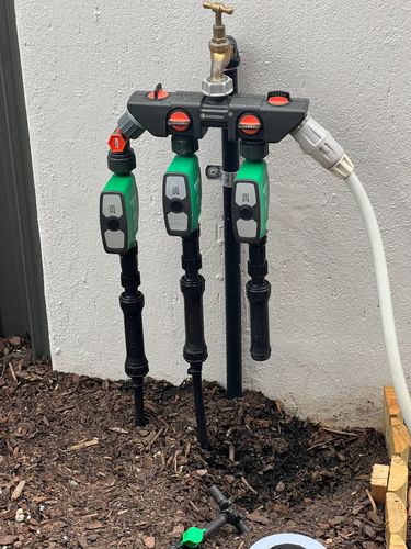

Thanks for your reply @JacobZ. Dave1 has been extremely helpful advising how to get a conduit through. It’s pleasing to hear I’ve covered most bases. This is the tap setup, so yeah I’ve split a few lines but the tap is maxed out so will get creative with the non-maxed out line. I’ve got them set to come on at different times. When I was buying the filter a colleague of your told me I didn’t want the reducer. I didn’t think the reducer affected water pressure, more reduces the connection to the 13mm poly. Is this right? Or have I installed the wrong thing (ie filter/reducer)?
I’ll add a photo so you can see what I mean about running a line along the front (I went back to this set up with the ‘stopper’ to isolate - didn’t mean I was isolating with a tee sorry). I need to add another 2-3 sprinklers to the front line so I can plant the front along to the fence. I’ve held off planting since the set-up is maxed. I’ll get the conduit sorted and run a second line next weekend. I’m digging out a clay garden with no drainage or any way to add a drainage outlet today. I figure digging half a metre down then adding soil plus another 300mm soil high is the best I can do  Much prefer playing with the irrigation ha!

Hi @Gerdener_Yoshi,
It looks like you've purchased the Holman 13mm Pressure Reducer And Filter Assembly, which comprises a pressure reducer and an inline filter. The pressure reducer limits the water pressure to a maximum of 800kPa to prevent damage to the irrigation lines. I doubt this pressure reduction is enough to make any huge difference, it is more of a failsafe than anything else.
With that third line installed, I can't see you having any issues with pressure. Once you can get the conduit underneath the path, I think you'll be good to go.
