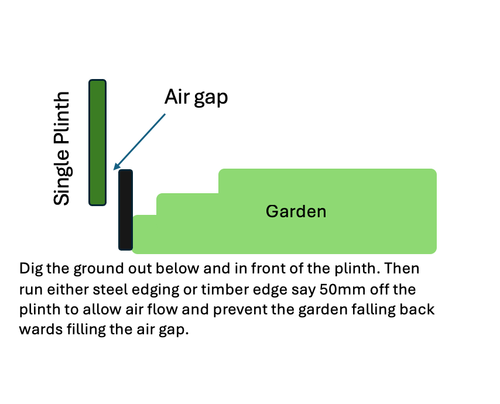

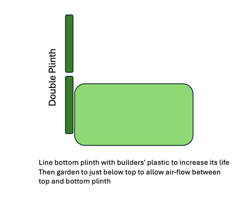

Congratulations on your new home. I definitely agree with @Dave-1 and would be keeping as much if not all of the under house ventilation. I see to often both work-wise and within this community, mould issues with homes with blocked or not enough ventilation points. Especially with older weatherboard homes.
Here are a couple of solutions to consider for where you have a single and double plinth boards under the weatherboards.

Thanks so much, this is very very helpful. You've understood the assignment spot on. I think we will make a Bunnings trip and find the correct depth steel or aluminum, dig the trench and install exactly how you've shown in Option 1. Thanks again!
