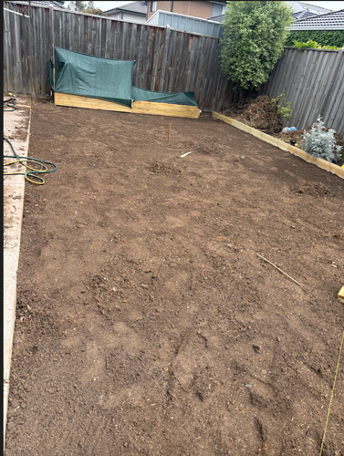

Thanks for getting back @JacobZ , sorry could not reply earlier. I have dug up the old soil in the last week, getting to the remains of any older root systems . In the process of rough levelling the same now, and based on that will order in the new top soil. Would it make sense to remove some old soil to make place for the new one ? current soil already sits 50mm below concrete paths..

Hi @Oscar13,
That soil actually looks very nice and should be perfectly suitable for laying your turf straight over. There’s no real need to add 50 mm of topsoil unless the existing soil is poor or compacted. Yours looks to be in good condition and well-prepared.
In answer to your question, if you do decide to add some new soil to help with levelling, it’s best to remove a bit of the existing material first so your finished turf surface sits flush with the concrete edges rather than above them. This will keep things neat and prevent water from running onto your paths.
You’re making great progress and the preparation work you’ve done will really help your new lawn establish quickly. Looking forward to seeing your results!

Hello @Oscar13
It appears that your soil still looks to be in good condition as Jacob mentioned. I don't think its necessary to remove the surface soil and just have the new soil placed over the old one. It will make a nice foundation for the new turf and after some time, the soil will eventually settle down to its natural level. My best advice is to remember to place a fall on the soil surface so that rainwater does not pool in the middle of your lawn.

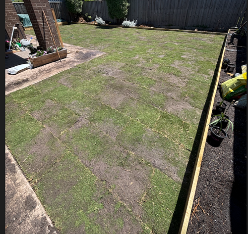

Hello Mitchell.. Apologies for the delayed reply.. Yes, I did try to level the soil again with a rake and it did turn out good.. here is what it looked after
Oscar13_2-1762108424350.pngT
The lawn arrived on Saturday and I managed to lay it down by noon.
I found that soil was fallen off from the lawn sheets and I did not go ahead and backfilled that when laying it.. not sure if that will become a issue later on, as I do see some uneven spots now, even though my soil level did not have any.. Wondering what my options are  ? should i lift them and fill the spots with a lawn mix ? or wait 2-4 weeks and then top dress and level the yard ?

Hi @Oscar13,
At this point, with the turf already in place, you are probably best to just leave the turf and manage any unevenness by topdressing later on. Regardless of how much effort you put in now, there's always going to be some minor issues to address, so I'd just focus on getting those roots established and managing things if they arise later.
Keep up the watering over the next 4 weeks and then reassess. You've done a great job up to this point, so I am sure you will continue to do so as things establish.
