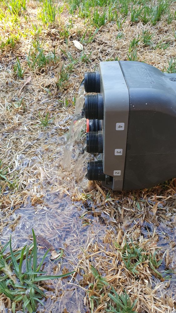

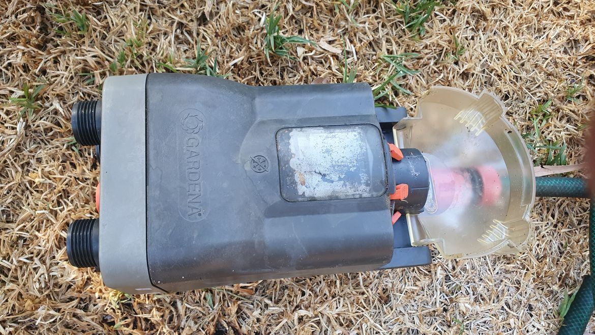

I have a GARDENA Water Distributor Automatic [Art. 1197] which has stopped changing ports. After reading an article on Bunnings workshop I disconnected it from the plastic pipes connecting it to the pop up sprinklers and removed it from it's mounting base. I opened all the six ports [ 2 were blocked as I only use 4 ] and ran water through it, It made no difference. i notice that the button you press to manually move the distributer from port to port has gone limp' I can press it all I like and nothing happens- there is no resistance at all?! HELP!GARDENA water distributor autoGARDENA water distributor autoGardena water distributor autoGardena water distributor auto

It sounds like your Gardena Water Distributor Automatic (Art. 1197) has an internal issue, likely with the spring mechanism that shifts the valve between ports. Since the manual button has lost resistance, the internal gear or diaphragm might be stuck, broken, or clogged with debris.
One of the first things to check is water pressure, as this distributor relies on a certain level to trigger the change between ports. If the pressure is too low, typically below 1.5 bar (22 psi), it may not switch properly. Try connecting it directly to a tap without the sprinkler system attached and see if it cycles when turned on and off.
If that doesn’t help, there may be an internal blockage. Since you have already flushed water through it, the issue may be inside the gear mechanism. Tapping the unit lightly while running water through it can sometimes help dislodge stuck debris. If that fails, fully disassembling the unit by removing the screws and checking the internal components may reveal a misaligned valve, broken plastic part, or displaced spring. If everything appears intact, applying a silicone-based lubricant to the moving parts can help restore function.
If the unit is beyond repair, Bunnings stocks alternative products such as the Pope 2 Outlet Tap Timer and the Holman 4 Outlet Tap Timer. Both offer multiple watering zones with automatic switching, making them a good replacement if your Gardena distributor is no longer working.

I was lucky! After flushing out and left overnight the manual button had freed itself, so I left well alone and it is back in service. Thanks.
