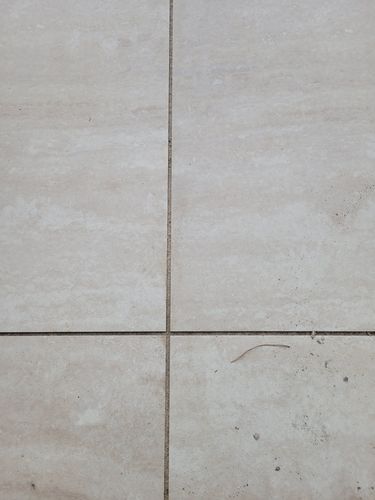

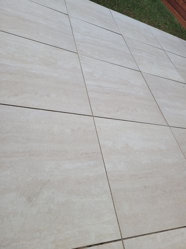

We recently had some paving done but the sand used just hasn't set so is constantly being washed/blown up.
Is there anything we can do to stop this and seal the gaps better? Almost like an outdoor grout?
I'm a total novice so any help is much appreciated!
Thank you

The pavers were laid about 3/4 months ago. They're 20mm think porcelain pavers laid on a concrete slab with sand/cement bedding and dingo polymeric sand in the joints.
We have asked the contractor back a few times and he's brushed more polymeric sand in which doesn't set and just blows back up.

Using an exterior grout is perfectly fine between our 20mm porcelain pavers, and I would recommend you go that route if you've experienced issues with polymetric sand. I suggest removing as much of the existing sand as possible and replacing it with Dunlop 1.5kg Flexible Coloured Grout. Here's a helpful guide: How to grout wall tiles. That guide is on wall tiles but it's a similar approach.

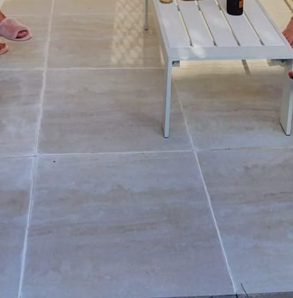

Outcome photo! The grout worked wonders, thanks again

Evening @CassFran
Wooohooo that looks great! And now I am glad I followed along :smile: Just learnt something new!
Thank you for the final pic :smile:
