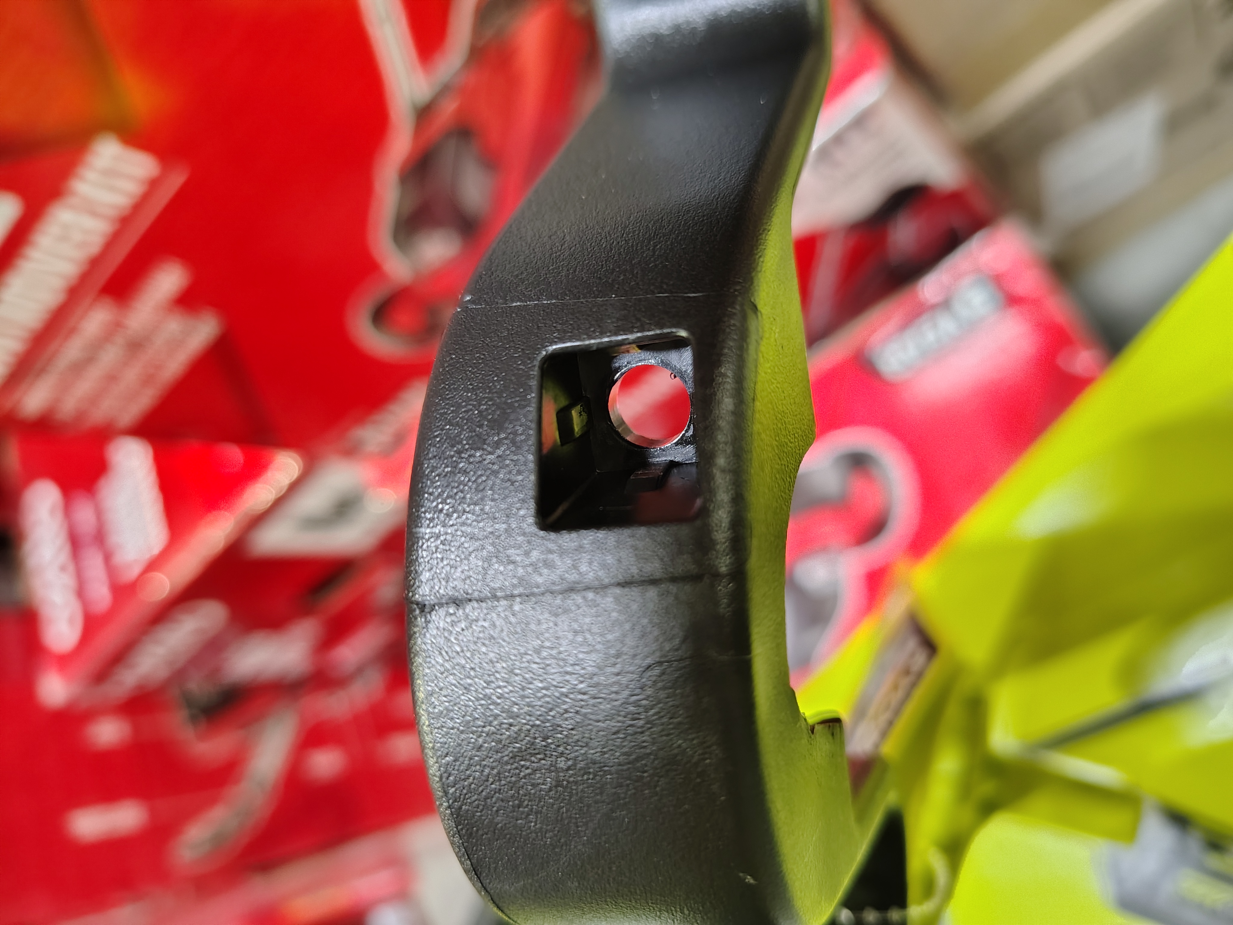

When the clip is inserted into the handle, the bolt/bracket hole are offset by over half the width of the bolt. No amount of force is going to overcome that.
R36LTR24 the manual is hopeless to interpret and everything I've found online says to insert the bracket into the handle, which in my case then doesn't fit (as per the photo above).

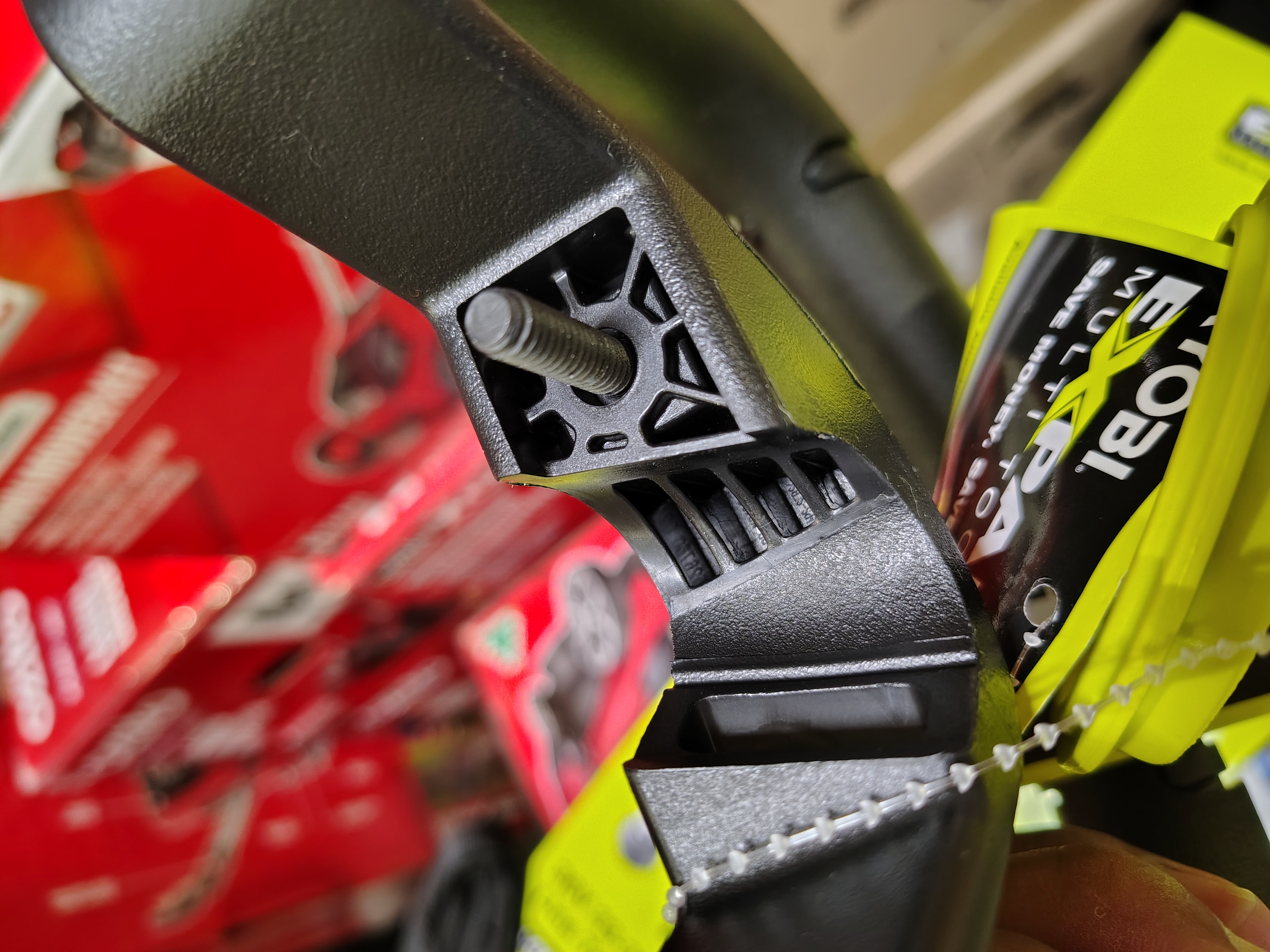

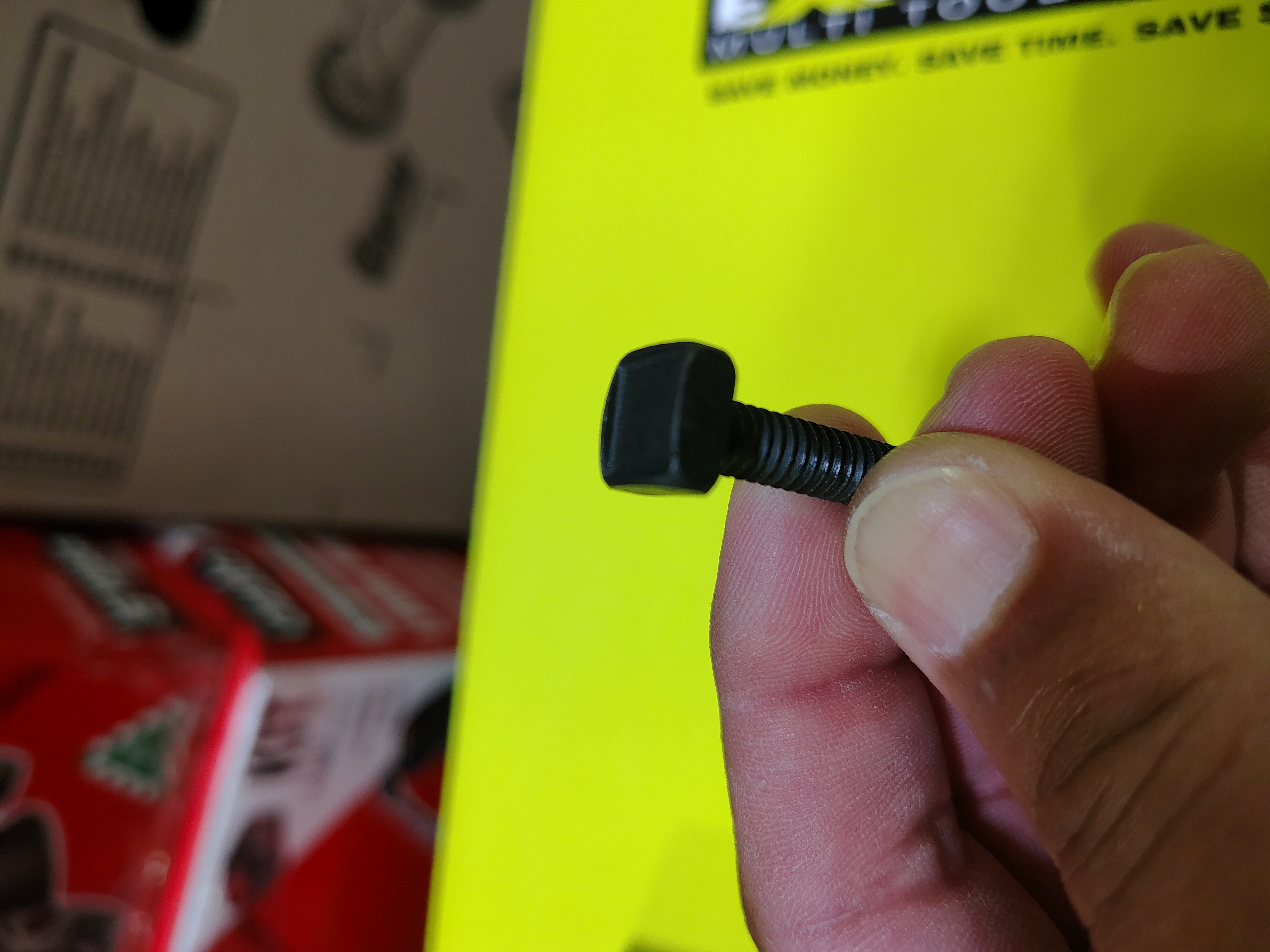

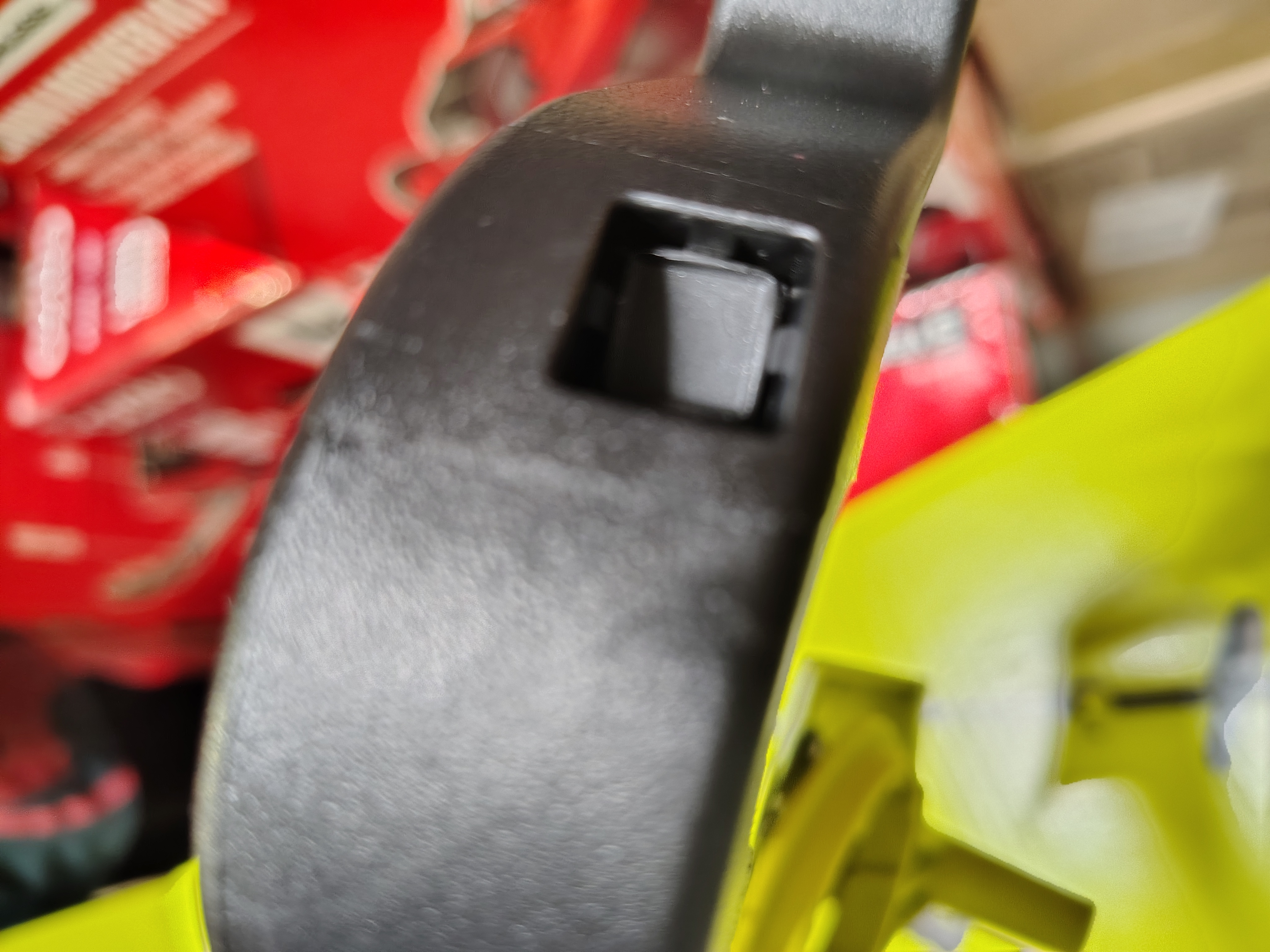

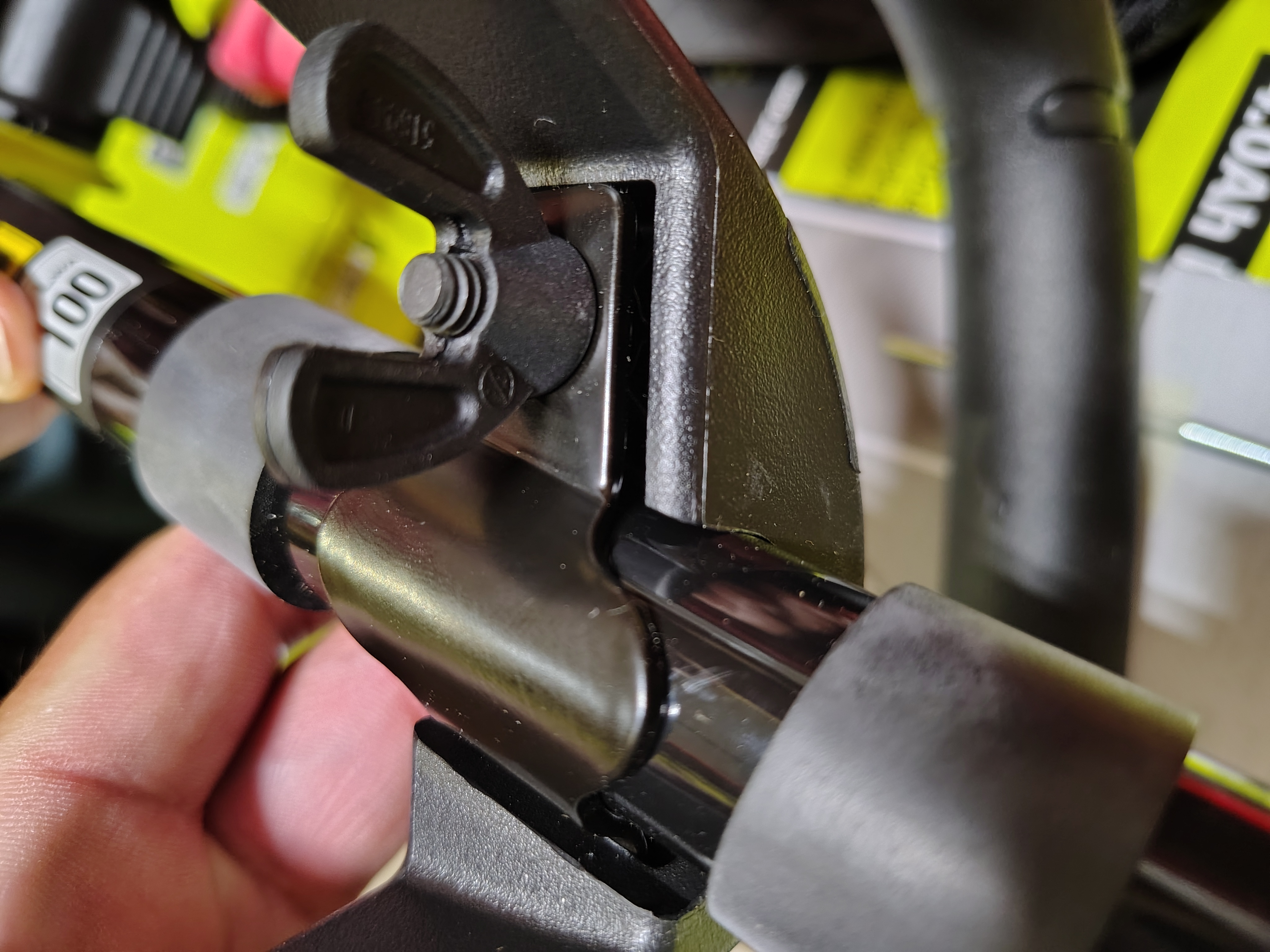

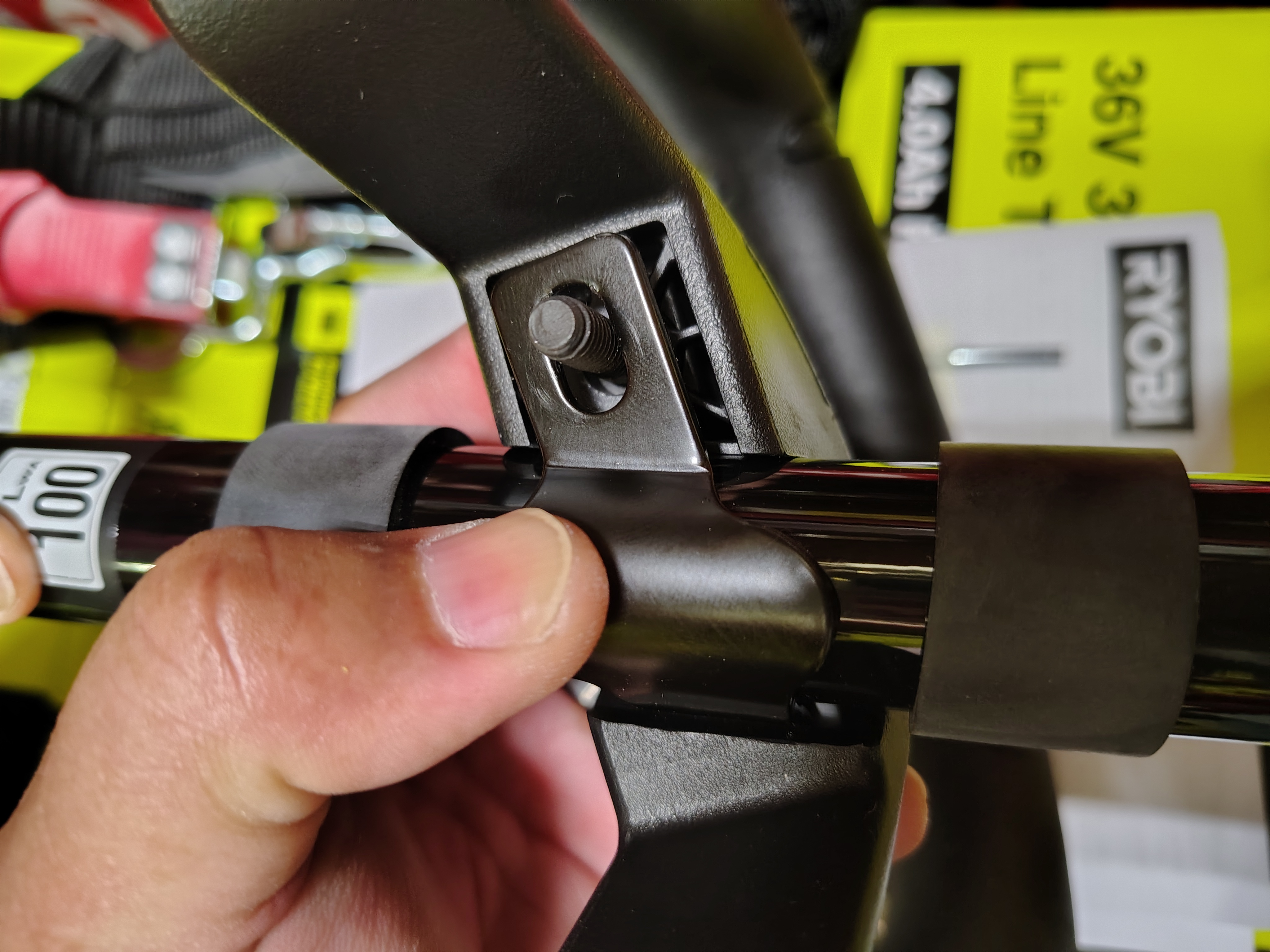

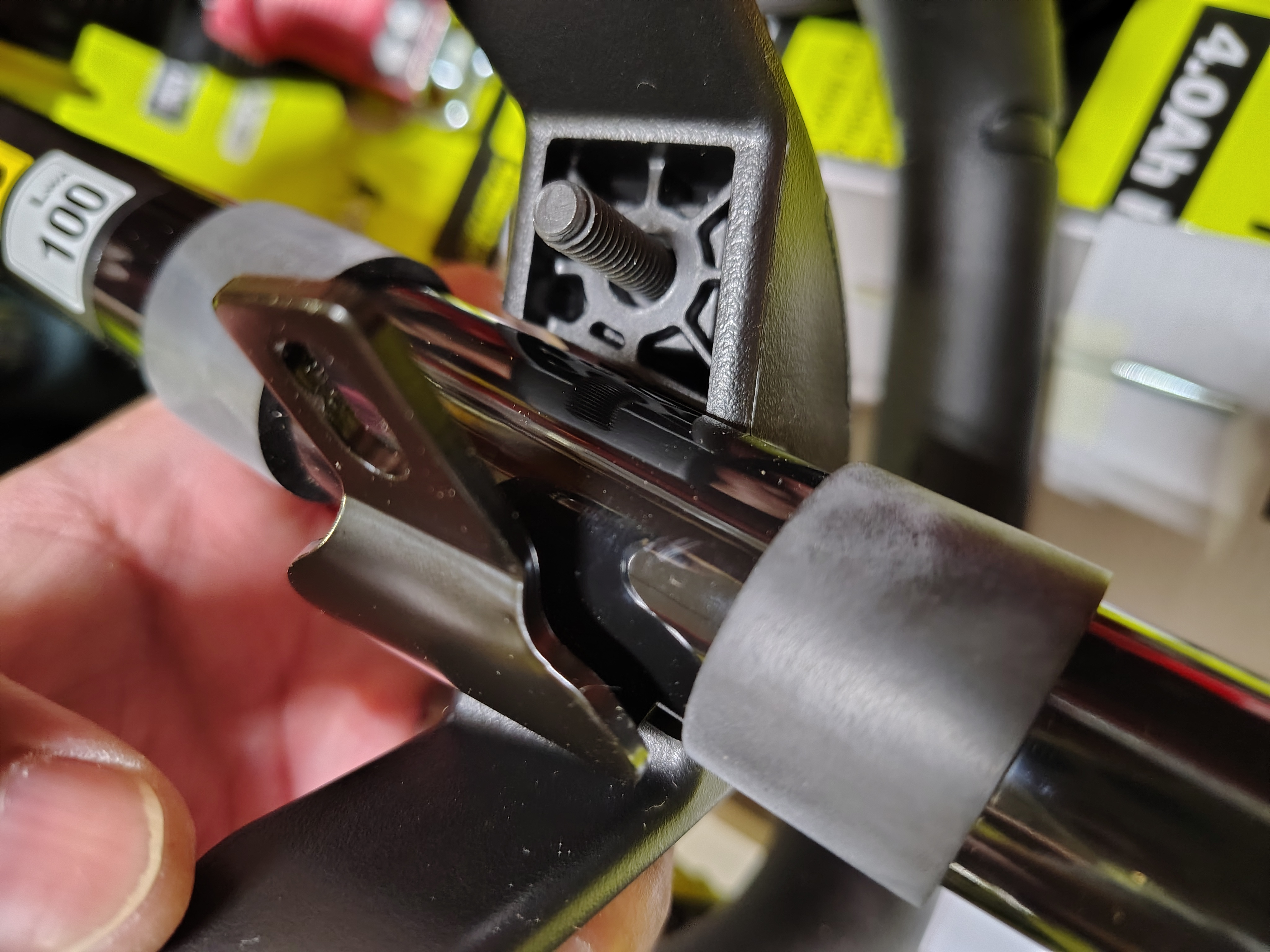

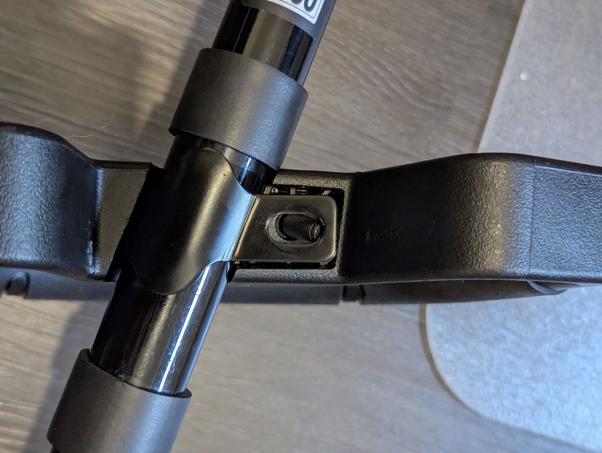

I've had a thorough look at the handle attachment process. What I noticed is that the screw that is used must be seated properly so that it stands vertically. Its square head must settle into the four plastic locking slots in the handle. You'll notice in the photo that it stands vertical and not at an angle. Next is that the metal clamp and the plastic handle must meet on the left-hand side first. Imagine a hinge where one side is attached first. Do not install the handle in all the way as this prevents the metal clamp from travelling properly around the pipe.
The handle and the metal clamp must come together like crocodile jaws clamping on a post. When brought together at the same time the steel clamp does not catch on the steel pole and provides a solid clasp to pole instead. Once seated correctly you can then install the butterfly nut and tighten accordingly. I've placed some photos below to give you an example of how its done.
Please give it another try and let us know if you succeed in clamping the handle to the post.
