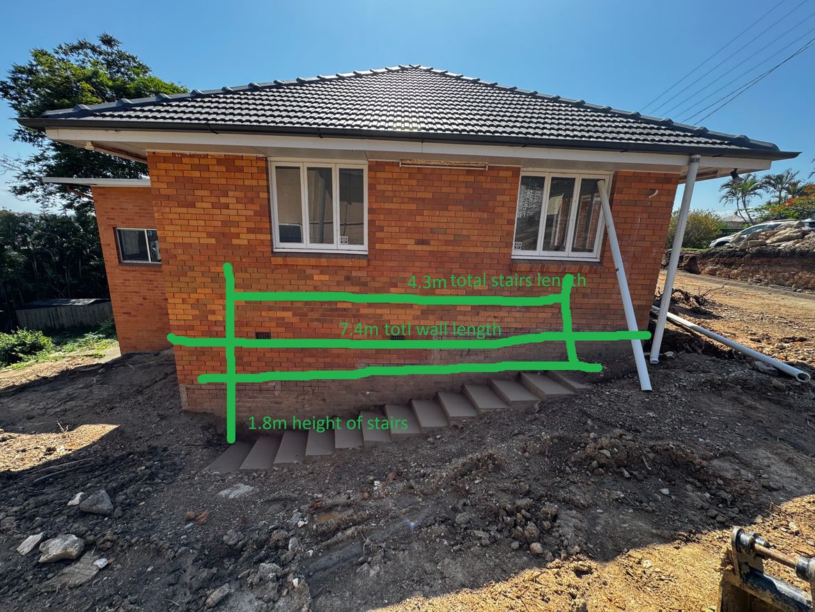

Question 1: Installing Landscape Steps Over Drainage Gravel
We’re upgrading our outdoor area and incorporating exterior waterproofing. As part of this, we’ll have a gravel path sitting above geofabric-wrapped drainage gravel, which covers the foundation drainage.

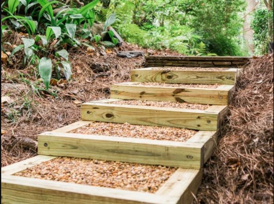

We’d like to install landscape-style timber stairs (see attached image for reference). Normally, these stairs require rebar—typically 450 mm long—driven through the riser posts into the ground for anchoring. However, one side of our steps will sit directly above the drainage gravel, meaning there’s no firm soil below for anchorage.
How can we construct the steps securely in this situation?
I understand one option is to move the steps roughly 600 mm away from the wall so they sit entirely over compacted earth, but ideally, we’d like to keep the stairs under the eaves for shelter from rain.
Question 2: Protecting the Waterproofing and Drainage Board
If we do keep the steps close to the wall, I’d prefer not to attach them to the brickwork since the wall will be covered in a dimpled drainage board as part of the waterproofing system. Any movement in the stairs could damage that layer. Is there a way to protect the drainage board while keeping the stairs close to the wall?

  • For the picture used the stairs were added in using ai, so not the best reflection of what we want the timber stair picture is much closer.

Hello @ChrisWWW
Welcome to the Bunnings Workshop community. It's sensational to have you join us, and thanks for sharing your question about installing landscape stairs.
I understand that you want the stairs covered under the eaves, but the consequence of covering the foundation drain makes this a non-negotiable installation. The stairs must be installed away from the foundation drain. This automatically removes installation issues and will not interfere with the proper operation of your drain. To protect the stairs, I suggest building a simple light duty rain/sun cover. Imagine a narrow timber pergola running from one end to the other.
The only other approach that comes to mind is to build it as regular timber steps but floating above the foundation drain. This will involve the steps being anchored to the brick wall using a ledger and one side will have posts buried in the ground like decking posts. It will need to be built high enough that it will not interfere with your drainage board.
Let me call on our experienced members @Dave-1, @Nailbag and @AlanM52 for their recommendations.

Good Morning @ChrisWWW
I am also hesitant about covering any foundation drainag. I see it as causing issues "down the track" I would move the steps away from the wall as @EricL has suggested, which will in turn put you back into the realm of being able to fix them nicely to the ground.
I have had to dig out next to the side of my house because the drainage issues that happened. The water would run up gainst the house, the old "waterproofing but not really waterporoofing" had failed and was allowing water to seap through the brickwork into my garage. So these days I err on the side of caution and think of "What ifs" :smile:
Gabion Wall to stop water ingress to garage  is the project I ended up doing to solve the water transfer issue.
Having a air gap between the house and soil is a better way of waterproofing, even a 20cm airgap would work well.
Maybe a mix of both? Move the steps over a little (which will allow acess if ever needed by for repairs/cleaning) and install an air gap maybe 500mm deep next to the wall?

Hi @ChrisWWW,
I also would prefer to have the steps against the wall.
Four posts with returns bracketed to the wall.
Four modular sections each one with it's own risers - and sides.
Each riser with wire mesh to contain the pebbles.
The modules are bolted so in the unlikely event of drainage issues the pebbles can be scooped out and the modules removed to gain access.
