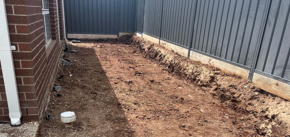

My backyard fence is higher than the house level. Roughly around 600MM height to the sleeper in the back fence . I want to build  a retaining wall from 400MM away from the fence  by using the versawall retaining wall blocks. But I'm not sure where it is suitable in this situation or not  or should i use the concrete sleeper retaining  wall with galvanized  posts?

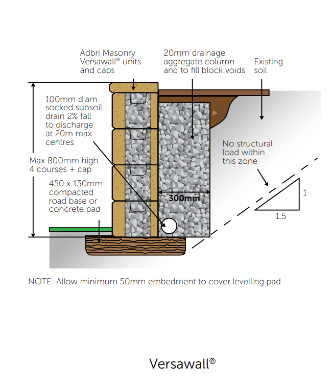

The Versawall retaining wall system can be used to construct retaining walls up to 800mm high without reinforcement as long as you follow the manufacturer's recommendations for installation, which can be found on Adbri Masonry's website. Here is a screenshot of a typical, unreinforced installation.
There are two things I note.
The first is the triangle on the right showing the exclusion zone for structural loads behind the wall. As long as your neighbour's house is not built within a metre of the fence, this shouldn't come into play. If it is, then you would need to speak with an engineer to confirm suitability.
The second thing I note is the need for a 300mm wide section of drainage gravel behind the wall. If, by installing your retaining wall, you were exposing the concrete foundations of your fence, then this could become an issue due to the proximity to the wall. Looking at the soil up against the fence, it seems likely that this may become a factor. In saying this, it would also be a factor with a concrete sleeper retaining wall.
To summarise my thoughts, you should first check with your local council that what you are proposing is allowed. Then, after this, confirm where, in relation to the wall, your neighbour's house is. Then, finally, whether installing a retaining wall this close to your fence will affect the integrity of its concrete footings.

Yes , We are allowed to build a retaining wall below 1m height . Neighbors house is 2m far from the fence. I think that concrete foundation may exposed if I build the retaining wall 400MM from the fence because it only covered with the aggregate  .

I believe 400mm should be enough when you take into consideration that you will be putting in a drain for your retaining wall. I propose doing some preliminary measurements and mark the direction of the retaining wall with builder's line and timber stakes. This will give you a much better idea of how far it will be from your fence and if it is suitable for your needs.

I want the retaining wall as the garden bed . I was thinking  that leave 600MM from the fence and fill the 300MM (from fence side ) with the Topsoil and rest with the aggregate and put the ag pipe or megaflow drain
