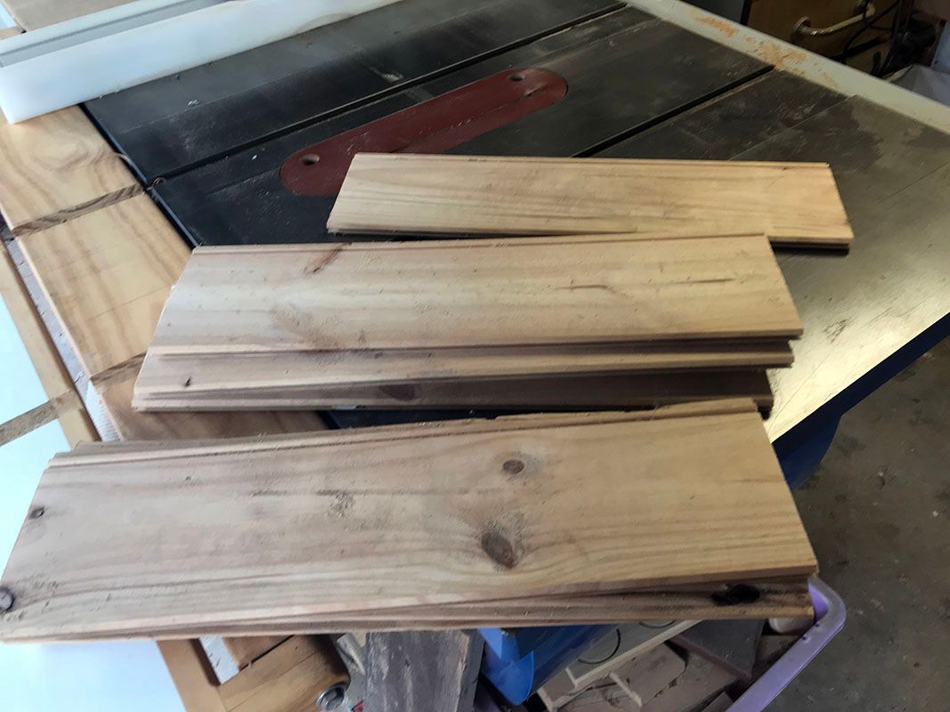

I was going to use pallet wood but had some Pine Matchboard laying around and have decided to use this, also being tongue and groove no need to mess around with biscuit joints.
I cut a board into 500mm lengths to make two roughly 500mm x 500mm panels,
Glued and clamped together.

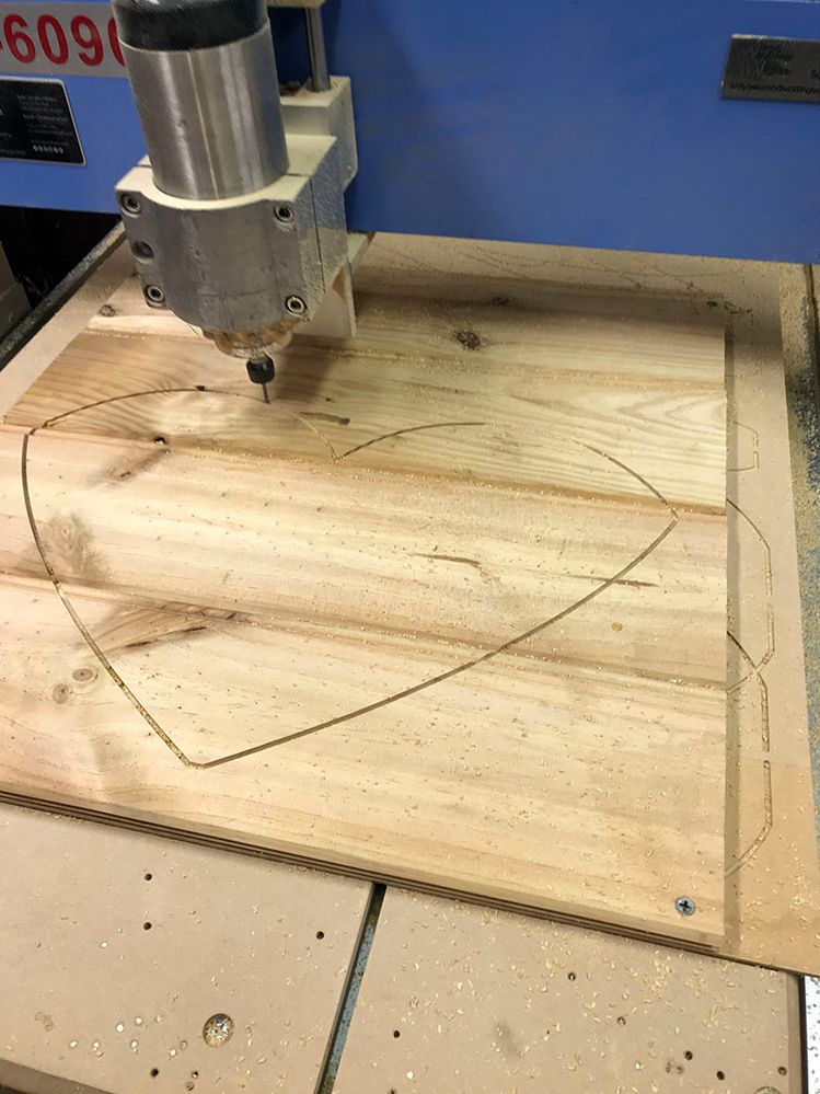

Once the glue has cured I needed to cut out the heart shape, I decided to make a half heart shape as the front of the planter. This could be done with a template and jig saw but I have a small CNC Router so I drew the design in the software and cut them out using that.

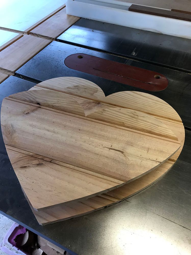

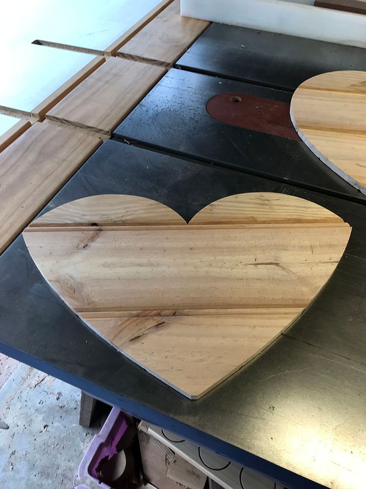

The back.
and the half sized front panel.

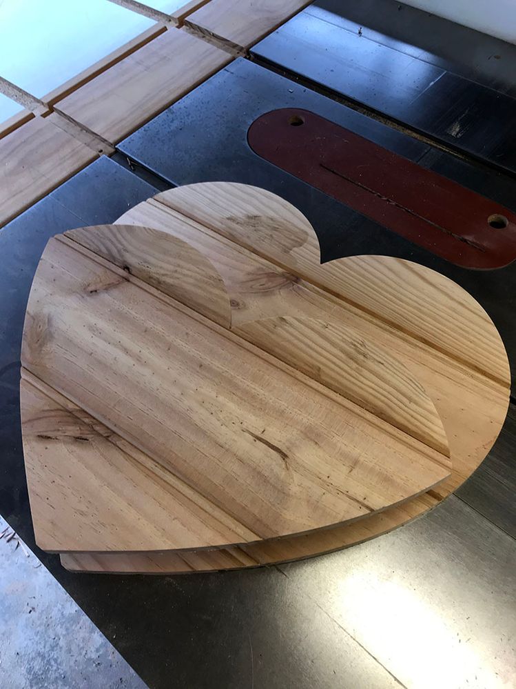

And an idea of how the two will come together.

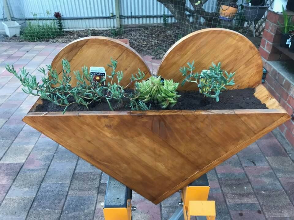

That is as far as I have got for now and I am wondering whether it is even necessary to box in around the top of the heart or just leave it as a flat back and just box in the planter section. I think it would look equally attractive and with far less work required.
I am open to suggestions.
A bit of creative licence, I am happy with that.
Woahh Wayne, THIS IS GORGEOUS!!!!!
It looks HUGE, the cuts are super clean with that CNC router, I vote leave the top of the heart open.

Needs a stand I think.
It is heavy, getting it to hang flat would be a challenge. I will i think make a small stand for it so it can live near the back door, not enough free wall space to hang it.
