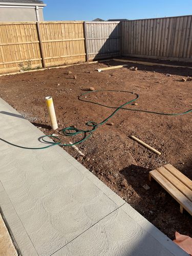

yes i plan to keep crushed rock as a base for whole backyard (turf+deck+path).
one more important thing which i am concerned about is the drianage.
there is a drinage pipe as shown in the picture. Do i cut it before the crushed rock is laid out or after.
what are the techniques i need to adopt so that crushed rock or soil does not get inside the drinage and block it if i cut it before.
i understand it needs be in level with the soil layer. I also plan to add small slope towards the house concrete so water comes down and goes into drian as shown in picture.
Re: backyard landscape please help!!
That pipe is something you need to be careful with @satwik. It should not be left open at any stage, because once crushed rock or soil gets into it, it can very easily block the line and create much bigger drainage problems down the track. From a compliance point of view, that pipe really needs to be properly capped or finished with an inspection opening, depending on what the pipe is actually for, and that work is considered plumbing and drainage work. In most cases, it requires a licensed plumber or drainer to do it correctly.
Ideally, the pipe should be capped or fitted with an appropriate inspection outlet before you lay your crushed rock, so it is sealed and protected while the rest of the landscaping work is carried out. Simply taping it up or loosely covering it isn’t reliable long term, as fine material will still find its way in. Once it’s properly capped or terminated, you can then build your crushed rock and soil layers around it and bring the finished level up flush with the surrounding surface.

Thanks mitchell. This pipe is definetely for draining backyard water.
i will cut first and then keep a cap and do remaining tasks around it.
May i know What level the pipe should be?
should it be 10-20mm above  base soil so water finds its way and soil does not go.
