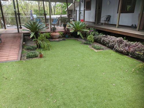

Re: replacing natural grass with fake one
Here's a pic of the area in the courtyard. I tried to get the morrocan style of pavers, which I cut the syngrass around, and the whole feel of coolth. The overhead membrane is retractable and I have a evaporative cooler arrangement with a infinity edged water feature to complete the impression and objective.
