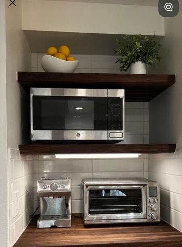

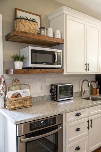

I would like to get a shelf similar to those for my microwave but I’ve been struggling a lot to find them how am I able to make one or where am I able to find one. They are either too small or don’t look like this I am trying to put my microwave ontop of it

Because you’re planning to put a microwave on it, the fixing is the most important part. The shelf needs to be solidly connected back to structural timber studs, not just plasterboard. In your second reference image, the shelf is well supported on both sides, which helps take the load. In the first image, the microwave is tucked into the corner where the shelf is strongest. You’ll notice there’s no weight sitting right out on the unsupported front corner, because there’s nothing there to carry that load safely. That’s something you really need to keep in mind when deciding how deep the shelf can be and where the microwave will sit.
