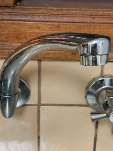

I bought Esatto 55mm 8 place setting benchtop dishwasher from Bunnings online. But the hose doesn’t fit into my kitchen tap. I went to Chadstone Bunnings for help but they said they don’t know how to do this. Could you please help? Thanks

Hello @znahar
One of the best assemblies I saw came from this discussion - Benchtop dishwasher quick-release connection by @jenenev
The assembly is composed of:
Remove the aerator from your spout and connect the Kinetic Aerator adapter. You'll want to attach the garden hose adapter spout. Assemble the brass barbed connector with some cut off hose from your garden hose outside. Clamp the hose to the barbed connectors. Attach the brass sprinkler adapter to your dishwasher hose. Make sure everything is tight and firm. Connect the assembly to your tap, slowly turn on the water to make sure there are no leaks. If there are no leaks you can start using your dishwasher.
