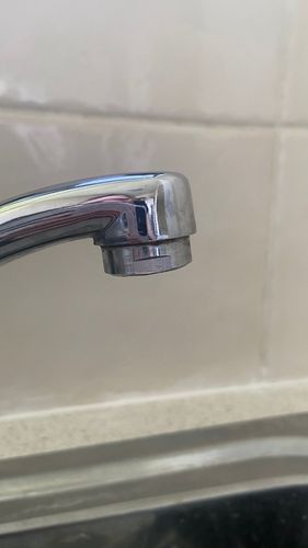

1) MY KITCHEN TAP: Is this ideal for a dishwasher hose to be attached and also easy enough to take the aerator off?

Still waiting on the dishwasher, but I did manage to unscrew the outer chrome, and there's a tiny bit of threading. Useless for the hose?
Re: How would I install this benchtop dishwasher?
Hi @bellamoure,
Unfortunately, it's unlikely that the thread would be large enough in diameter to attach the hose to. Just to confirm, is the aerator thread anywhere near 19-20mm?
It's fairly likely that you'll have to use a Pope Indoor Tap Adaptor to connect to that thread, then a Pope 12mm 20mm Sprinkler Adaptor American Thread and 12mm Double Ended Hose Connector to adapt the connector hose so it can be connected.
It's about closer to 23-24mm by my measurement.
So if I'm understanding right, I'd remove that outer chrome tap bit again and replace it with the Pope Indoor Tap Adaptor, then the Sprinkler Adaptor would screw into the dishwasher's inlet hose, then they'd both connect using the Double Ended Hose Connector?
Hello @bellamoure
Yes, that is correct you have the sequence correctly assembled in your description. My best advice is to make sure that the fittings are firm and secure but not overly tight.

this is a photo of my kitchen  tap with the aerator still screwed in….
Re: How to connect benchtop dishwasher to kitchen tap?
Hi @jab89,
The Kinetic 19mm Dishwasher Adaptor has a male 19mm BSP thread, which is equivalent to 3/4 inch, so it makes sense that the hose would connect to it.
The female thread in your adaptor is 1/2 inch, which works with 15mm metric fittings, so we'd need to find a way to adapt from the female thread in your tap to that 1/2 inch female thread in the adaptor.
Female to female threaded connections are made using a plumbing part called a nipple. If the female thread in your tap is also 15mm, you would use a 15mm Nipple. If the thread in the tap is larger, you would use Reducing Hex Nipple.
So, essentially, we need to know what the size of the thread is in your tap to select the correct part. If you can remove the aerator from your tap and measure the diameter of the opening, I could certainly point you in the right direction.
Let me know what you find.
