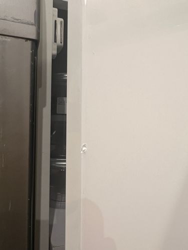

Hi all, when I move the furniture I accidentally hit the cupboard door in the kitchen. Now it has a chip/hole on the side of the door and I use white paint to cover it. However it is still so obvious there is a chip there. Is there anyway to fix it?

I suggest cleaning the area of loose melamine and lightly sanding it with a Trojan 320 Grit Jumbo Sanding Sponge. Wipe the area clean with a paper towel and fill the indentation with Timbermate 250g White Wood Filler. I suggest not overfilling it so that it will be easier to sand down. Once the filler cures, seal it by using Melamine Mend Paint White 12.5ml.
Please note that the sealer will have a low sheen finish and will have a different tone of white from your existing cabinet door.
