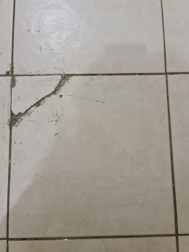

Hi Mitchell,
I have these cracked tiles in the kitchen area. What's the best way to repair this without replacing it?
Re: How to fix a tile without replacing it?
Welcome to the Bunnings Workshop community @AaryaR. It's brilliant to have you join us, and many thanks for your question about repairing tiles.
It looks like those tiles have significant cracks and surface damage, making a full repair difficult. You could try filling the cracks with an epoxy putty and then using a touch-up paint to blend the repair, but given the extent of the damage and what appears to be previous repair attempts, replacement would likely be the best long-term solution. If matching the existing tiles is an issue, you might consider removing and replacing a larger section for a more seamless look. Let me know if you’d like advice on the replacement process.
