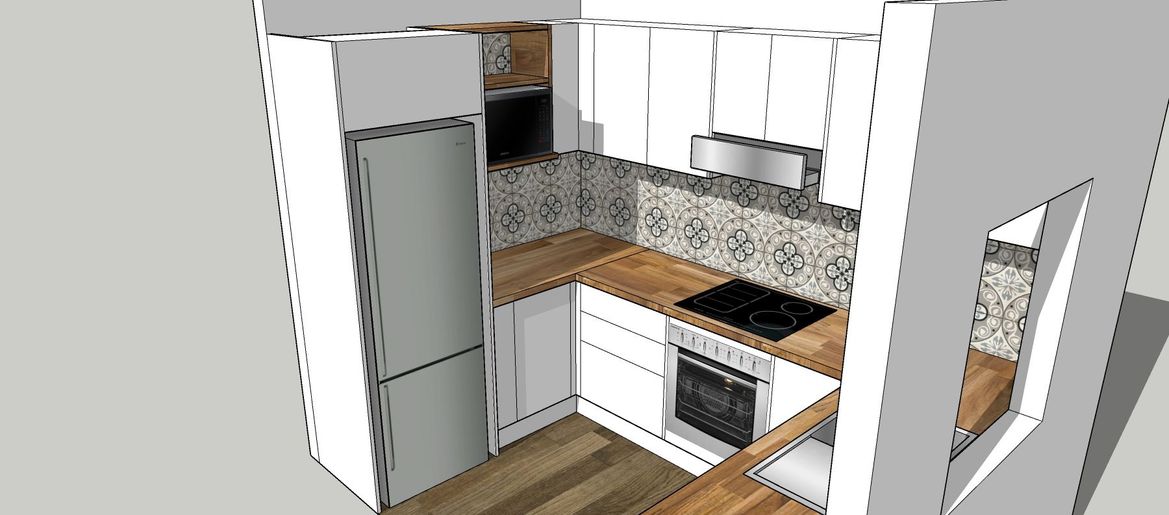

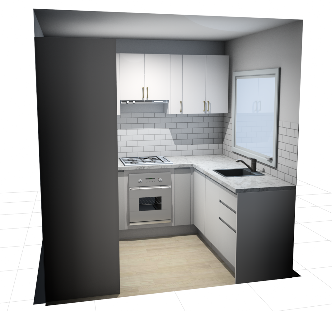

Hi @Jxc045,
Just following up on @EricL's behalf. I've taken a stab at that design for you, and it does appear there was a bit of extra cabinetry in the previous design. I certainly couldn't fit in that amount. In fact, to get you a drawer set in there, I've needed to remove the dishwasher. It was either that or make your oven very off-centre and lose lower cabinetry space in the corners.
Let me know what you think.

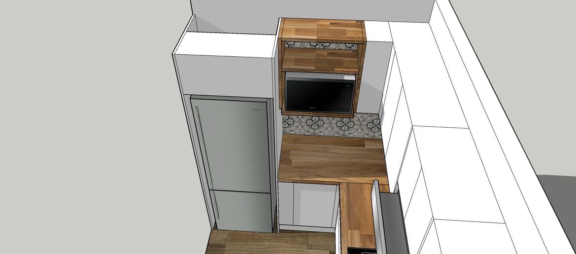

As far as I can tell, there is not enough room to fit your blind corner cupboard door, drawers and fridge along that wall @Jxc045. It is much the same as the other side, where there's not enough room to fit a dishwasher, sink and the blind corner cabinets door. We could not do the blind corner cabinet, but you'll lose the entire corner's worth of storage space in the back corners; there will just be a large inaccessible voids under the bench. You can see in the image below I've added your dishwasher and drawers. No matter where I move the oven, I cannot give you a corner cabinet with access to those areas left open in the corners. You could have the bench extend over there and slip in a couple of thin cabinets to fill up some space, but I can't give you access to those areas.
Since it's such a tight space, it might actually be beneficial to head into your local store and sit down with a kitchen design expert for a consultation. You'll be able to work with them to lay out your kitchen exactly how you'd like it.

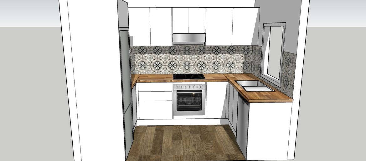

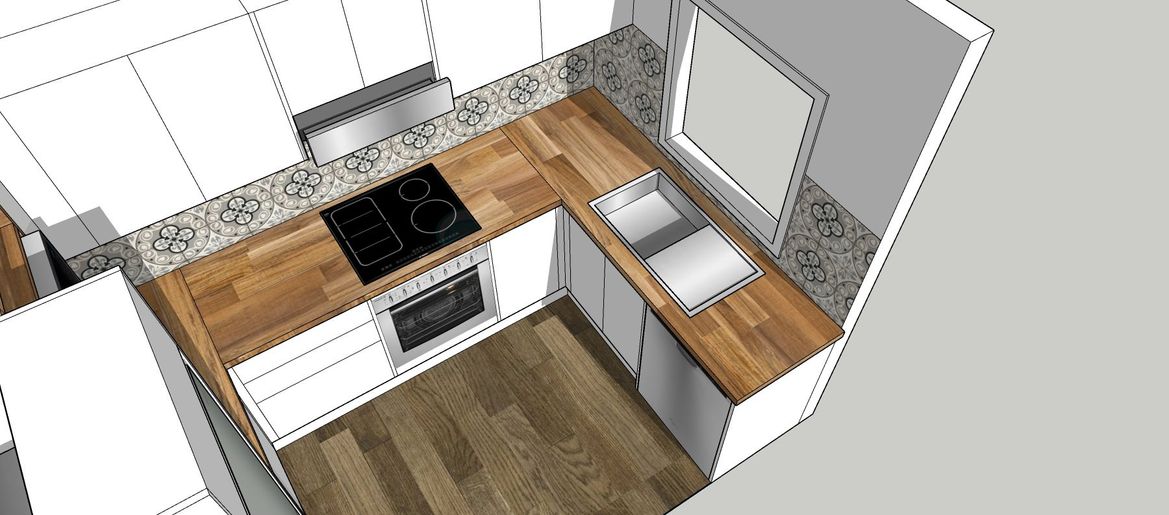

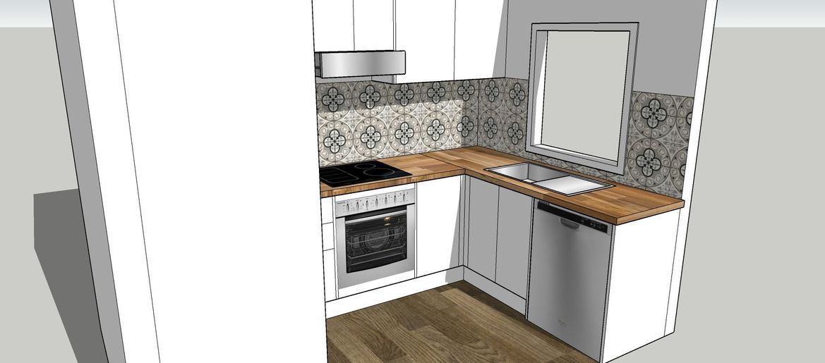

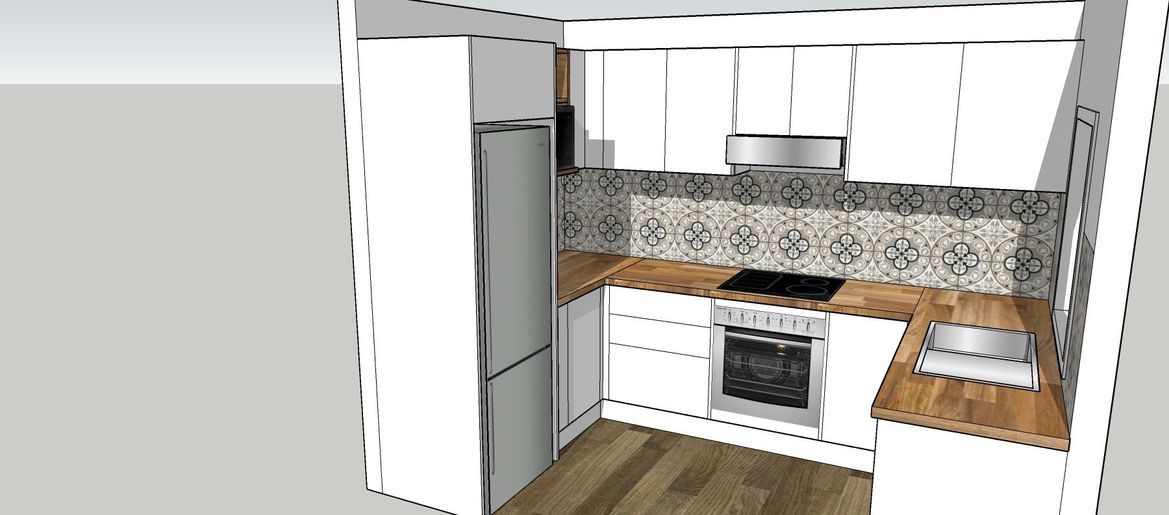

Hello @Jxc045
My apologies for the late reply. I've redrawn your kitchen with your requests placed in.
Due to the limited space I'm afraid there is very little space to move. I've placed two blind corner cabinets in your cabinet run and there is just enough space for your sink cabinet and your dishwasher. I've placed your drawer on the left-hand side of the oven so that it will not interfere with the dishwasher while its open. It is possible to put in a 300mm pantry, but it will add a bit of an expense to your budget.
Please have a good look at the layout and if you have any questions about, please let me know.
