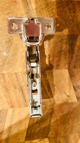

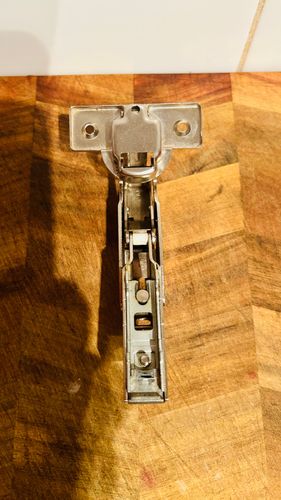

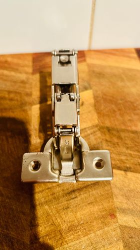

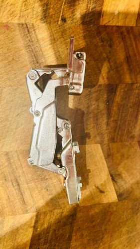

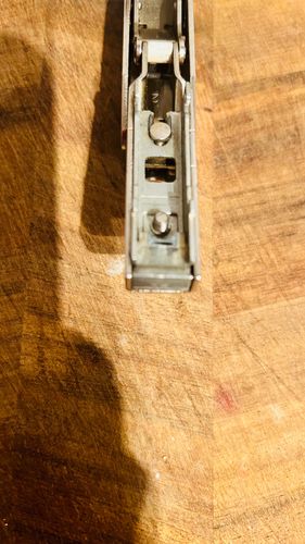

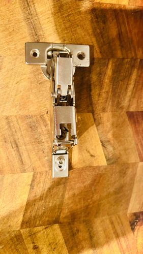

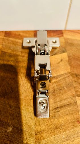

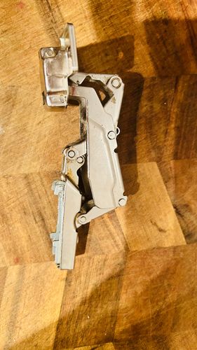

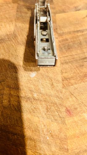

Hi all, sorry, this is doing my head in! I’m trying to find a replacement hinge for a corner cabinet. It has 180 degrees imprinted on it, but I can’t find any readily available hinges that have this span at Bunnings. If I don’t have any luck, could always redrill and install a new hinge, popping a cover plate/wood puttying up the old site, but this would be less than ideal. Replacement is needed as the existing one wore out from wear and tear (small metal ‘tooth’ broke off so when trying to click the two parts together they don’t lock in place)

The most effective way to match up cabinet hinges is to take your current hinge to your closest Bunnings store and have a team member assist with matching it up. The matching process involves placing your hinge alongside those that are available and selecting the closest one. Depending on the make, you will likely need to adjust the mounting screw holes, but hopefully, there's one close enough that the rebated section doesn't need to be moved.
