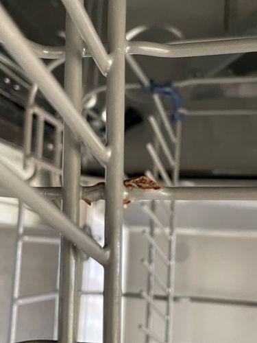

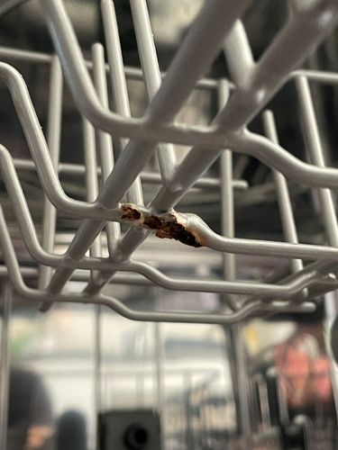

I have a small piece on the dishwasher rack where the plastic has split and started to rust. A replacement rack would cost more than $100 dollar.i am hoping to get some advice on after removing the rust, what should the remaining metal be covered with?
Something that would withstand the heat and not be toxic.

I'm sorry, but I'm currently not aware of a product that will stop the rusting on your dishrack. Unfortunately, most of the repair items I'm aware of are not food safe or made to operate in high temperatures. It's possible for you to sand down the rusted parts, but it will eventually come back.
I'm afraid I can only suggest that you replace the rack with a new set. You can at least be sure that the new rack will give you a few years of service and be safe to use.
