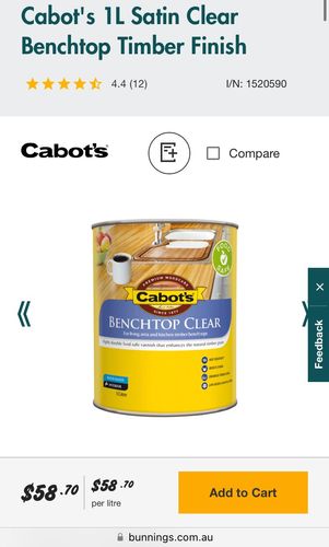

Hi, I’m using Tasmanian oak hardwood panels for a kitchen bench and plan to seal it with this Cabot’s product - minimum 3 coats. How many coats should I do on the underside before putting the bench top in place please.
Hi @Christine61
A standard two coats will give it a good surface seal from underneath.
Water entering from the edges is a weak point in most timbers so @2 -3 coats the same and one for good measure on the edges will close of water to the timber.

Hello @Christine61
I'm in total agreement with @Jewelleryrescue. A minimum of two coats will be good but a third coat is excellent way to protect the surface of your timber benchtop. My best advice is to make sure to apply the same number of coats to the outside edge and any area that has been cut.
Please make sure to give each coat enough time to cure properly. Applying the clear finish too early will result in a poor uneven finish and extended drying times.

Thank you Eric and @Jewelleryrescue for your advice.
There isn’t a great rush for it so I can definitely leave time between coats. My current hold up is that my local Bunnings is out of stock! Hopefully that means it’s a good product. It’s had great reviews.
Hi @Christine61
It's an excellent product as I've used it on most of my upcycle projects in the past. Can you please tell me what is the closest store to your location? I'll try and locate another store near you that has this product in stock.
All is well, I’ve located another Bunnings in my area with stock (according to the website) Thank you for your help. I’m not quite at the stage of sealing, I just like to have all my ducks in a row as I work through the process.
