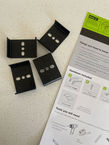

I have purchased the 2 x 31L pullout bins by Kaboodle, and am at a complete loss as to how to use these additional black plastic brackets that came included.
On the instructions it says they may be needed if not using a Kaboodle cabinet, which I’m not - I just have no idea how they’re supposed to be used?

Hi Eric,
Thanks for the link to the video, but this doesn’t show exactly how to use the extra brackets?
My cabinet is slightly larger so I need to use them, but I have no idea how they attach or are used to fill the additional space?
Ashlea
Hello @ashleasmith
The brackets are attached to the side of the cabinet, but before you attach it, I suggest measuring the gap first to make sure that it is compatible. Sometimes the gap is bigger, and it will be necessary to use timber to take up the slack.
Another item that you'll need to get are the screws, these will depend on the thickness of your cabinet. The brackets are not guaranteed to fill all the gaps. I've placed an image below to give you an idea of how it is attached.
Ah amazing, this is what I couldn’t envisage
thank you!
