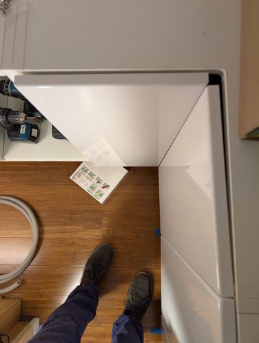

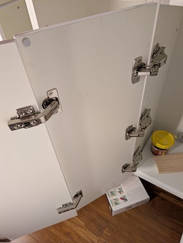

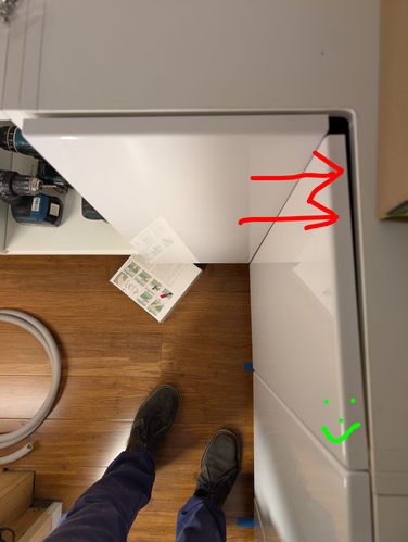

So I've hung my corner wall cabinet doors and although they are aligned from the front with the neighbouring cupboards, the secondary door on the corner cabinet sits out from the cabinet as pictured.
What's gone wrong and what adjustment on which set of hinges should I be looking at to get this door panel to sit flush with the cabinet

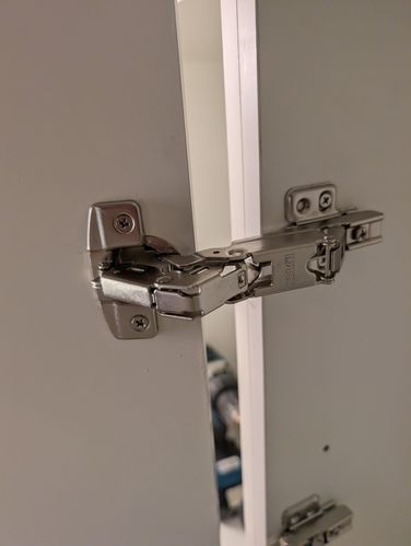

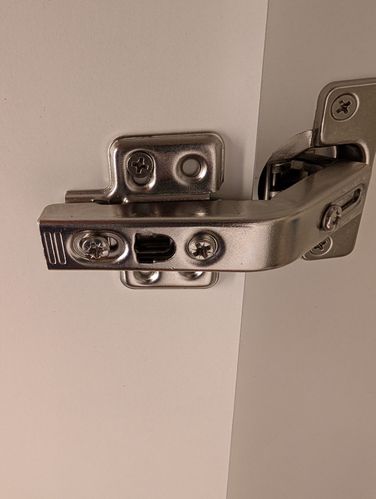

On your third photo is a picture of the hinge in the middle. It has three screws, starting on the left is the one that adjusts the left and right distance of the door. The one in the middle adjusts the forwards and backwards distance and the last one controls the gap between the doors. I propose leaving the first screw alone, turn the second screw anti clockwise twice and loosen the third screw and move the arm out until the third screw is in the middle of that adjustment bar. Re-tighten the third screw till firm repeat the process for the bottom hinge and test again.
You should in essence have the door flat against the cabinet with the gap between the doors balanced. If not, you'll need to fiddle around with the screws on the hinge until the door is flat and balanced.
