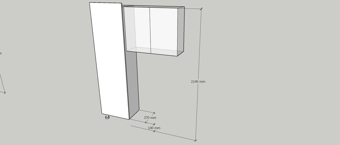

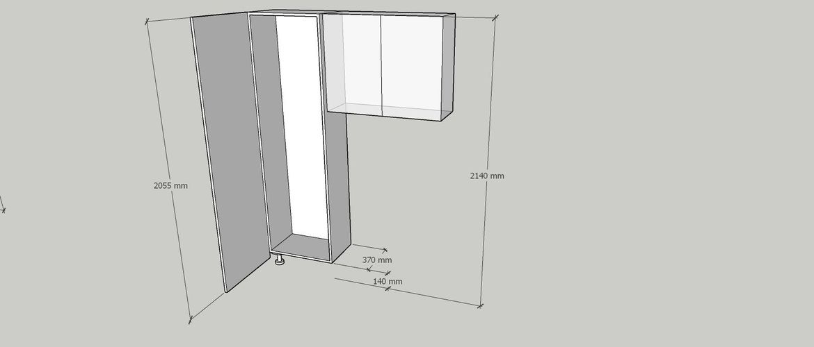

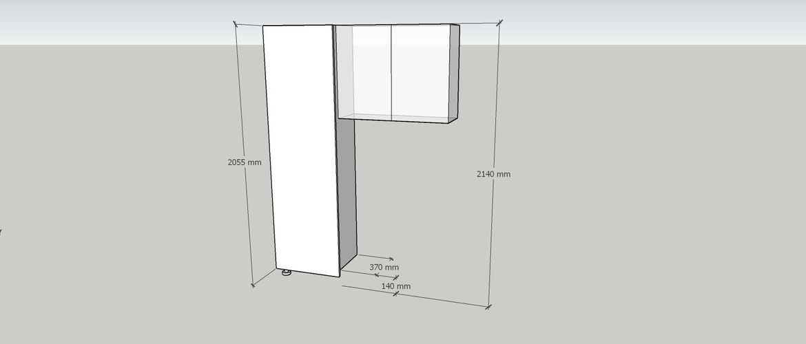

I agree with @MitchellMc 's suggstion that you split the difference and put 1.5mm on each side of the door. The Kaboodle doors were built in such a manner to allow clearance for the door panels to be adjusted and miss each other when they are opened when they are next to each other. There are host of other reasons but the one I mentioned is the one applying to your situation. Now concerning the height difference, you will see in the illustrations I've made that most pantry cabinets are usually at the same height as the wall cabinets. Mind you this is not always the case and some pantries don't line up. I suggest putting the excess height of the door to the bottom end of the pantry. That way you won't have to build anything extra and makes the cabinet look more streamlined rather than having it the other way around. If you manage to line up the pantry with the other cabinets then having the pantry door at the same height as the other cabinets makes it look uniform and not out of place. Please have a look at the drawings and post any questions you might have.

With the kaboodle foot on and the door excess to top end.
When the door is closed and you can easily spot the excess height of the door.
Excess height at the bottom. But the door is now correct at the top end of the cabinets.
With the door closed and the excess is not so easily seen!
