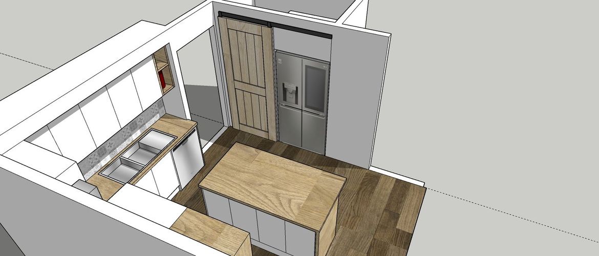

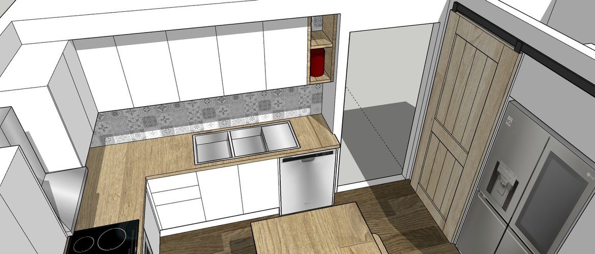

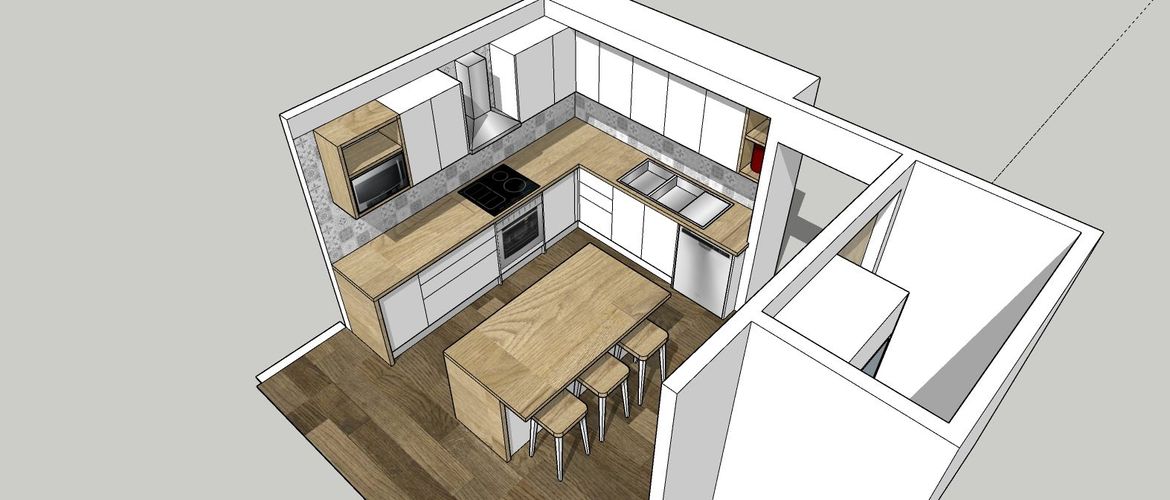

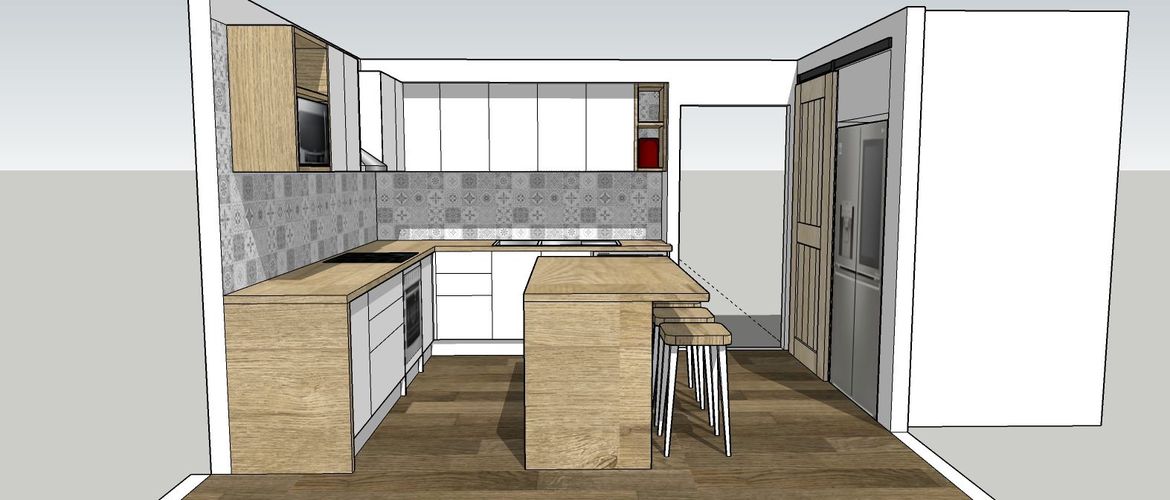

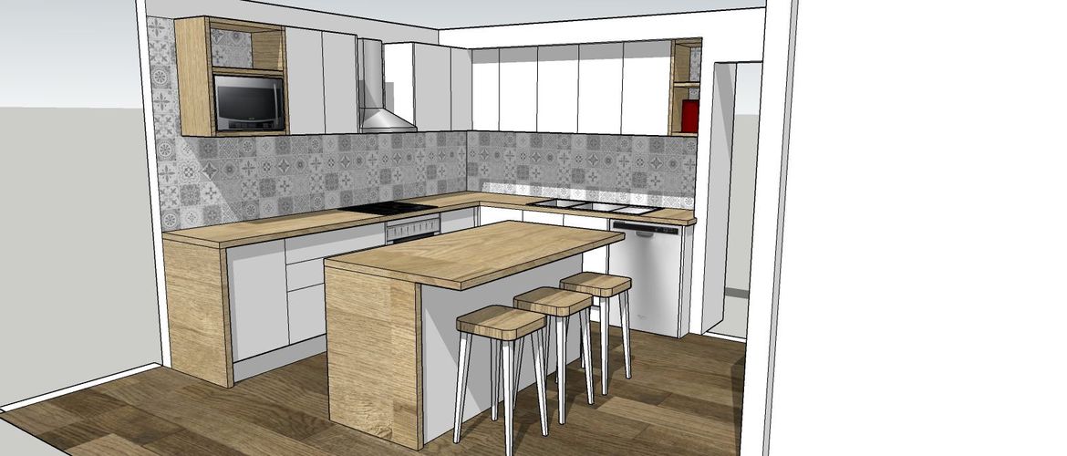

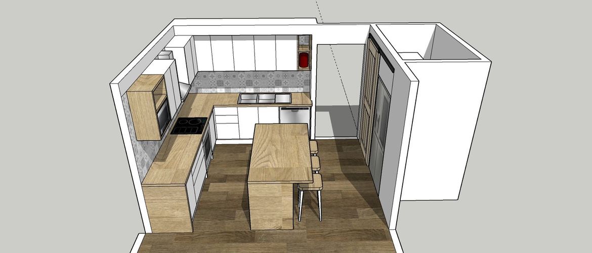

Hello @georgiaks
I totally agree with @MitchellMc 's recommendation to build a wall in front of the old brick cooker. Mind you I suggest having a look at google what model you have as some of those steel wood fire burning stoves sometimes fetch up $1,000 dollars and up! I suggest the following :
- Remove the doors and panels in the old pantry set, we will add that space to your kitchen as seen in my drawing.
- Remove the cornices and finishing panels near the pantry and where your old sink is to give your room a more uniform finished look.
- I suspect you have an old post war home or an older model as the ceiling height looks like it is at 3 meters.
- Your old sink spot now does double duty as fridge space and walk in pantry with sliding barn door. I will leave the placement of the shelves to you as you can customize it to your cooking appliances ( kitchen aid, waffle maker etc. ).
- Once you build your extra wall it has to go all the way in to your old pantry to give the kitchen a straight line and we wont have to modify any of the cabinets.
- The wall will not take up that much space. But before you seal it make sure that the chimney and all other flues going through your ceiling has been decommissioned and sealed. Last thing we want is to have critters taking up residence behind your wall.
This is what it could be, I am aware that there are other ways to re-design this kitchen but time and money are always a factor in these things. But you are in the planning stage at the moment, look around at other kitchen designs and incorporate those things that you want into the current design and come back to me and I will modify the drawing for you. Please post any questions or queries you might have we will more than happy answer them.
Cheers,
Red
This is the best spot for your sink as you can tap in from the plumbing of the bathroom which is just on the other side of this wall.

Thanks Red. We were looking at a second hand kitchen that had the stove and sink in opposite spots (ie. the stove on the same wall as the bathroom, the sink on the plaster wall in front of the alcove) do you foresee any problems with plumbing? I assume it would just cost a little extra to get it plumbed.
Hello @georgiaks
I don't see any issues with the reversal of the cook top and sink. However it's best to consult with your plumber to head off any possible problems with the set up of the waste water and water inlets for your sink. Always have your quotes in black and white that way you are not caught out with sudden "unexpected" surprises. Having the cabinet carcasses set out will give both the plumber and electrician a good idea of where things will be and allow them to measure out for the job at hand.
