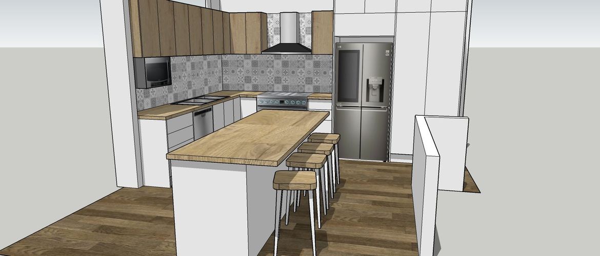

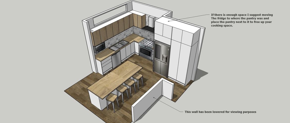

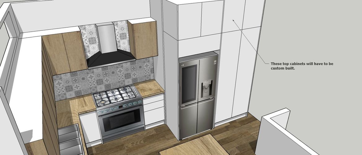

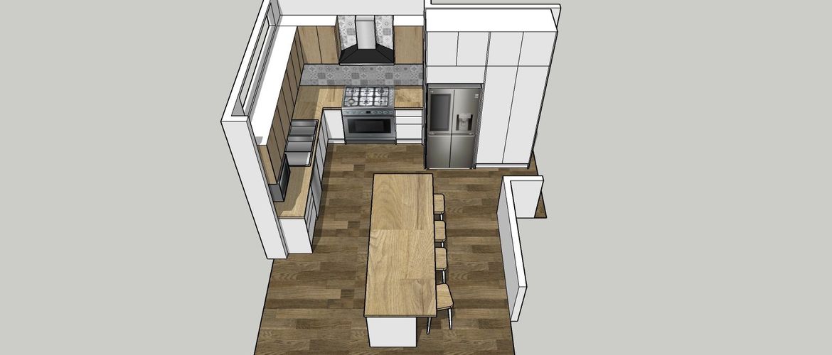

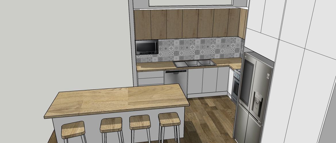

I agree with @MitchellMc a skylight would illuminate your kitchen much more along with your wall cut out. I've drawn the breakfast bar area a little bit differently. Please enjoy the drawings and if you would like to see a different lay out please drop us a line here on workshop. Good luck and stay safe.

Thanks for the idea of the island in the centre, I'll have a play with this thought
I did think of putting the fridge more in the entranceway, but the corridor isn't big enough to allow for this.

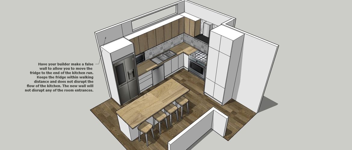

Hello @wendalls
I had a feeling that might be the case. How about this suggestion, build a false wall at the end of your kitchen run to allow the fridge to be moved to the end. Have a look at the drawing and tell us what you think.
