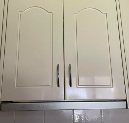

A. Changing the Rangehood to this: https://www.bunnings.com.au/bellini-90cm-stainless-steel-canopy-rangehood_p0186539
my existing one is:

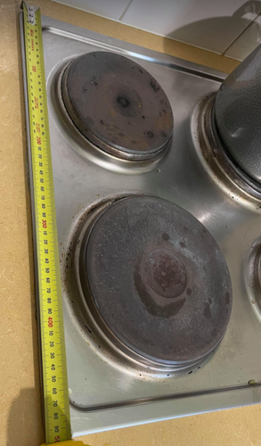

B. Changing the Cooktop to induction or ceramic cooktop, like thishttps://www.bunnings.com.au/bellini-60cm-induction-cooktop_p5103044
my existing one:

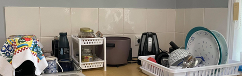

C. Change splashback to thishttps://www.bunnings.com.au/vistelle-700-x-745-x-6mm-mist-glass-splashback_p2669127?gclid=CjwKCAiAsa...
   The current one is :

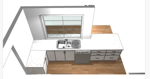

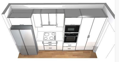

The following drawings were created by one of the Bunnings consultants when he visited my house.
Do we get to buy complete kitchen sets like above, cabinets, and pantry overhead cabinets from Bunnings and how do we go about that?
I have seen on youtube people buy kitchen set, they get delivered and they can install themselves. That will work for us.
And if so, how do we manage the cutting of benchtop especially around sink (for new sink) and cuts to adjust window part that falls on benchtop.
I see some options available in IKEA (I hope you do not mind me mentioning other brand here ) to purchase complete set as well.
Thanks for your help.

The entire kitchen can be purchased and delivered to your home. If you have experience in assembling and installing cabinets, you should be able to put them together yourself. However, I suggest engaging the services of a trades person to install the benchtop as it is very technically involved especially near the window.
However, you can have your entire kitchen installed for you as the store has a kitchen installation service. This includes plumbing and electrical service. Please speak to your stores kitchen specialist if you wish to find out how much it will cost to install the kitchen for you.
I've drawn up a sample of your kitchen with a larger benchtop and a smaller pantry but with more drawers as an option.

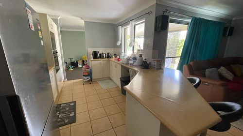

@EricL  With some budgeting going towards laundry renovation, the kitchen renovation is going to be delayed (looks like it) for a while.
However, the Flooring still being priority, we are thinking if the flooring job can be continued to the kitchen and living room areas while doing in the Laundry area.

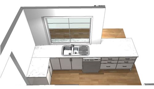

I am a little concern about the future once the flooring is done now in kitchen area based on the current design and purposed design (we want to go with this future). Following are the design again.
Current Design
Purposed Design

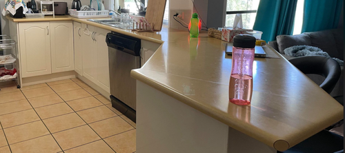

If you see current design, one end of the benchtop and the whole cabinet finish off on angle, whereas the purpose design has perfect L-shaped benchtop design.
Let's say we do the flooring now around the current design ( which has the angular finishing - indicated by Green markers), and later want to start Kitchen renovation, will we be able to do the adjustment of the Hybrid flooring around the Angular area ? Will we have flexibility of taking out the Hybrid panel and etc.
Apologies if I am not making sense here.
In overall what I want is with Purposed Desing, we might need to add, cut, take out, reinstall hybrid flooring to make the seamless flow around the Angular Areas, when they are turned in to L-Shaped, will I have any difficulty ?
And, will I have more moving opportunities/ flexibility if I go with Hybrid Flooring or proper tiling ?
I really appreciate your advice here.
It is hard to prioritize the work when the whole house needs renovation :smile:
Dave-1
Community Megastar
Re: Right Sequence of Kitchen Improvements
Afternoon @Sugar
How essential is that chopped off cupboard area? Would it be possible to shorten it without ripping the whole lot ot? That way you could work on your floor in preperation of the new kitchen benches?
The carcass should be able to be dismantled from each other (inside cabinet wuill have screws between each shell) and the bench can be cut through using a circular saw and handsaw.
Hello @Sugar
Thank you for letting me know that your kitchen revamp will be delayed. I strongly recommend not doing your flooring in the kitchen until your new kitchen is installed. It is very difficult to rearrange the hybrid flooring once it has been installed and there is the possibility that the panel lengths will be incorrect which means entire sections will need to be relayed and re-cut.
From an installation point of view, it would be better if the flooring was installed only once and that is when the new kitchen is put in.
