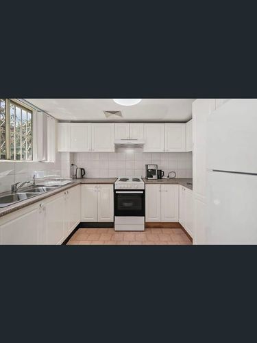

hi Dave. Here is a photo of my kitchen.
Hello @sammyla
Thank you for sharing that photo of your kitchen. I propose starting with the doors and removing the handles and hinges so that you can stack them neatly. I then suggest getting a plumber and electrician to remove the sink, plumbing fittings and appliances. This will then allow you to start removing the cabinetry without having to worry about those parts of the kitchen. I recommend finding a dumping spot for the panels outside your home so that it does not become a hindrance inside.
Once the cabinets are off you can then assess the condition of your walls and find out if any repairs need to be done to it. Can you please tell us the size of your kitchen. We'll be more than happy to draw up a sketch of your new kitchen.
