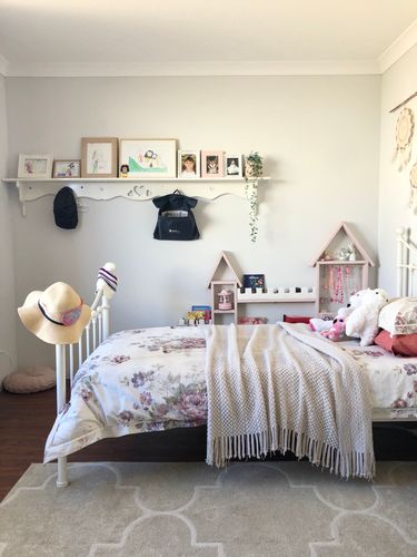

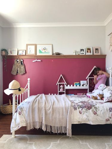

A little project I did with my daughter this week.. she asked for a pink wall in her room so we went to Bunnings and she picked the colour “Heartfelt” by Taubmans.

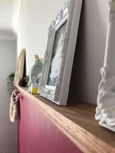

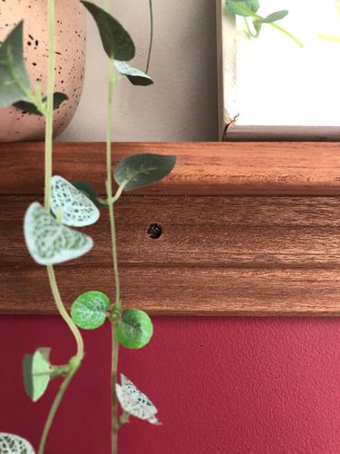

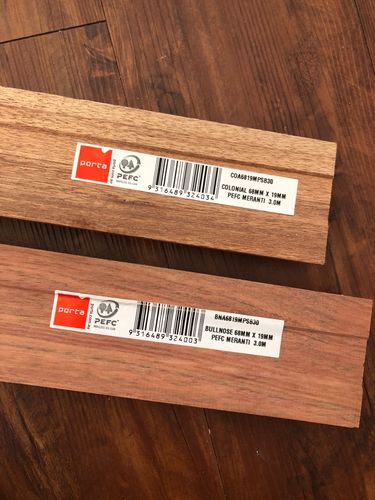

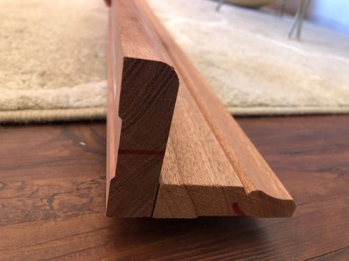

I also made up a new shelf for her framed artwork etc, using timber skirting boards (1x colonial and 1x bullnose).
I basically just screwed them together and then attached it to the wall. I used the colonial piece for the bottom piece against the wall as it has nice detail, with the bullnose piece on top as the shelf, with the back of it face up - the “cutout”on the back of it works really well for keeping picture frames in place.
Originally I was going to prime and paint it white but I ended up loving the raw timber look so we left it.
Overall it was a very cheap & easy makeover. My daughter gave it the thumbs up. 😉👍🏻
