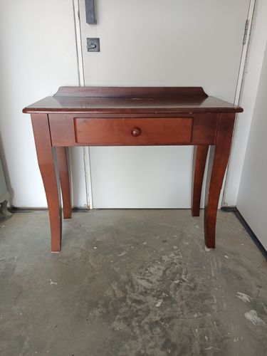

Distressed console tableThe original boring console table definitely needed a revamp.
It had a little damage on-top so I decided to go with a distressed look for a rustic modern vibe

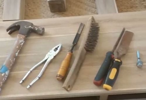

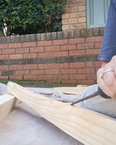

I used a chisel to remove square edges on parts of the legs
Tools

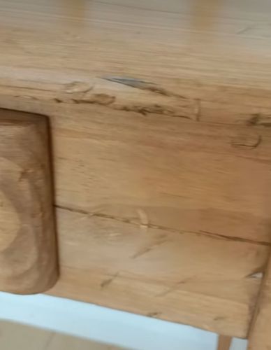

Tools used a hammer, bolt, chisel and other tools here to create the distressed texture on the timber.

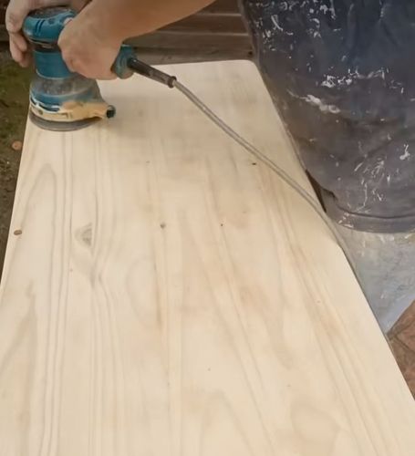

I used a markita orbital sander on the entire piece.
Steps
Step 1
*After removing the back piece I cleaned it all down with sugar soap and warm water
*Started sanding with 80 Grit sandpaper working my way up to fine 240 - sandpaper and fine paper 400grit to smooth in between coats
* I used a hammer both sides along with other tools to create dents, texture & lines, along with a chisel to remove some edging

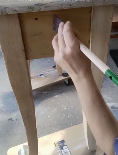

*Stain - is "diluted" Brazilian roast stain & vanish @cabots in water based and diluted it down with mixing 1 part stain with 4 parts cabothane clear sealer

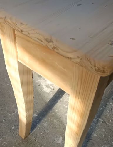

After sanding and distressing the piece. Raw version. Before staining

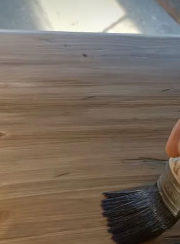

Application of the diluted stain Brazilian Roast in cabots using a brush and applying along the natural grain of the timber

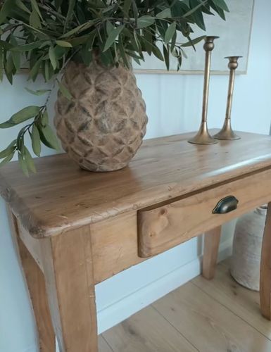

Close up results of the finished look
