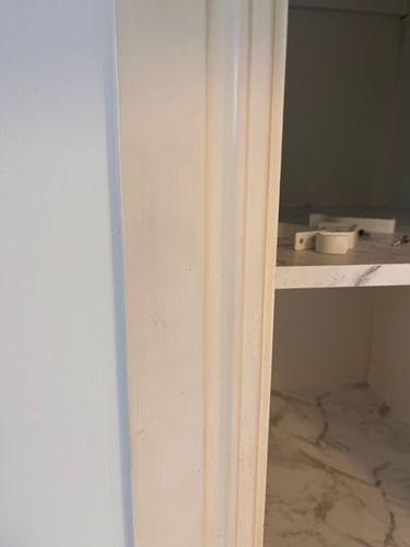

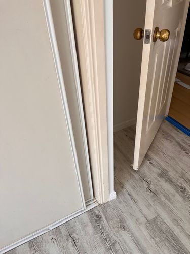

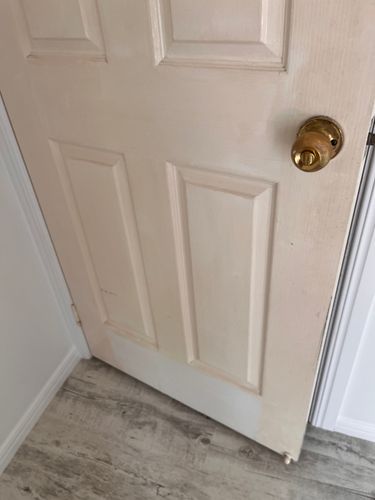

How much sanding for doors and frames needed before painting?
Re: how much sanding do i need to do for these waredrobe frames and door before painting
Hello @angelique5
Your goal is to get a uniform dull/matt finish. All the shiny or glossy parts of the door or wardrobe frame must be removed or sanded down.
