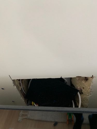

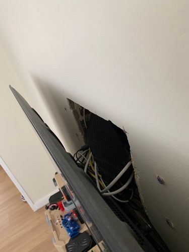

Hi everyone,
I’m looking for some ideas on how to cover a 350x350mm hole behind the TV, where the internet router, power board, and all the wiring are located.
I was considering a thin plastic cover or lid, but if anyone has a better suggestion—something neat and low-profile—I’d really appreciate your input!
Thanks in advance!

Good Evening @MartinB84
A question first, your router is in the wall? Does it have to stay within the wall?
If it doesnt then I would be following @EricL 's suggestion, that wall plate really works, I have two in my libary that I have run cables between and out of sight. If the router has to stay within the wall then is it possible for a photo of the hole itself? I would probarly suggest to frame the hole up and install an actual door to gain access. You will come up with issues tho as routers every now and then do tend to need power cycling so having it in the wall behind the tv may be a pain.

As with @Dave-1  would definitely consider relocating the equipment externally the wall. The additional heat will reduce life and possibly cause overheating issues. is there a cabinet below the the cables can be run internal of the wall to?
Then patch the wall and install the DETA White Brush Wall Cover Plate - Single Pack that @EricL suggested.

Sorry I forgot to mention that router, power board and all the wiring have to stay in the wall.
The lid/cover ideally should have a gap where the tv cable come out.
all the rest must stay in the wall.
ventilation is not an issue
thanks

In saying this, something like an access panel is likely what you'd be looking for. You could then use the method @EricL mentioned through the door of the access panel. You would have to cut a hole in the panel to install the brush plate, which you could do with an angle grinder.

Then id go for the option of framing out the hole, I would also close fit a lid with some finger holes in it so you can pop it out if needed (Tight so it stays in place, no hinges) . Ventilation holes are definently needed plus the cable access. A metal access lid may shield the routers signal. There is another discussion thread in here where someone had their router in a metal box that was fine and teh job the person was doing looked pretty nice.

From the photos looks like a layperson has been at work?

I would be quite concerned with that stuff being packed into a wall of my house, especially if there is a power board in there as well.
I don't want to scaremonger or come across as silly, but if one of the plugs on that power board, for whatever reason, should come loose, you can conceivably end up having a fire start in your wall, this may go unnoticed before it causes serious damage.
Just a thought.

Considering all the safety concerns I will get someone to patch the hole, install a couple of power points and bring the internet outlet out.
Im happy as long as everything is concealed behind the TV 😊
